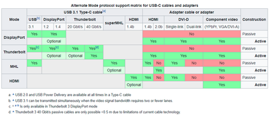

and this table also from https://en.wikipedia.org/wiki/USB-C#Alternate … _specifications
(left half applies to USB-C to USB-C cables) :
41.33 KiB
Again I don't see the problem here? The table says a USB-C -> USB-C cable supports all features.
