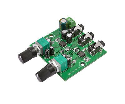

Also, I'm gonna look for a braindead cheap solution ready-to-buy or make my own breadboard circuit at least, of a simple audio 2x1 audio mixer, so I can make this box mix the fm/sb signal to the output of a Roland module, which would be great for all those games which decouple the sound device choices between these two. I don't think I want individual volume control but I might change my mind. Most solutions on Amazon are $30+ things and it ought to be cheaper than this. Basically, the absence of a physical line in socket forces me to look for my own external hardware solution, which could come handy in other projects.

Reply 127 of 1049, by rasteri
You get these sorts of things on ebay -
The attachment s-l1600.jpg is no longer available
