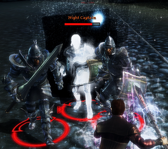

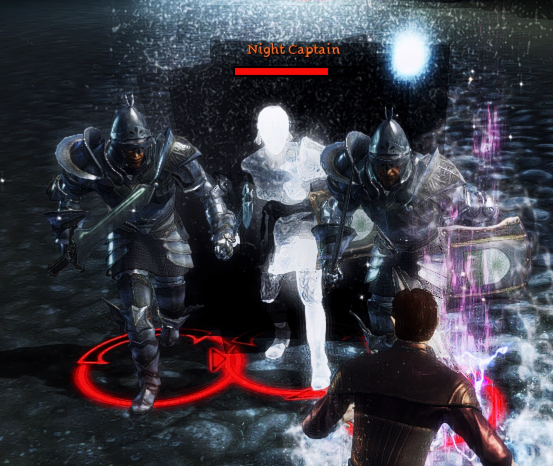

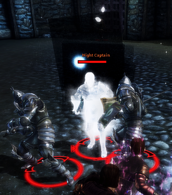

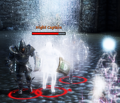

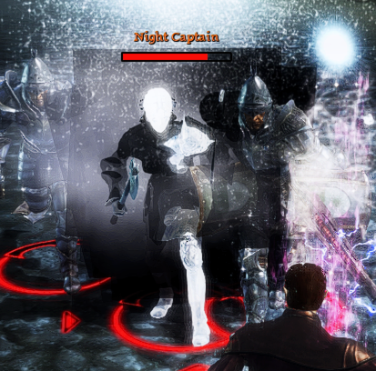

I've been messing around with dgVoodoo2 in Dragon Age Origins, and I found that versions of dgVoodoo2 from 2.8 to 2.82.5 have an issue with certain magic effect textures appearing black. Here's some screenshots of what it looks like when a mage uses "Winter's Grasp" with one of the effected versions installed:
Screenshots of broken texture.
daorigins_broken_effect_texture_01.png daorigins_broken_effect_texture_02.png daorigins_broken_effect_texture_03.png daorigins_broken_effect_texture_04.png daorigins_broken_effect_texture_05.png

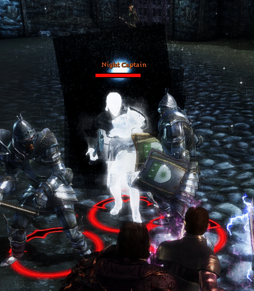

This seems to be a regression from 2.79.3 where this effect texture worked fine. Here's a screenshot of what the "Winter's Grasp" effect looked like in that version:
Screenshot of working texture.
I think I might have seen more broken effect textures when playing the main campaign as mage, but at the time I switched to DXVK since I was having issues using ReShade and dgVoodoo2 in Dragon Age Origins. I can't remember for certain though, as it was some time ago that I originally tried the game with dgVoodoo2.

I've been messing around with dgVoodoo2 in Dragon Age Origins, and I found that versions of dgVoodoo2 from 2.8 to 2.82.5 have an […]
I tested all the spells I could cast (Winter's Grasp does nothing for me) but didn't see any black texture. One thing though: I remember patching this game to 4GB aware otherwise the rendering might have had missing parts when the memory usage reached 2GB. Maybe that, I don't know.
