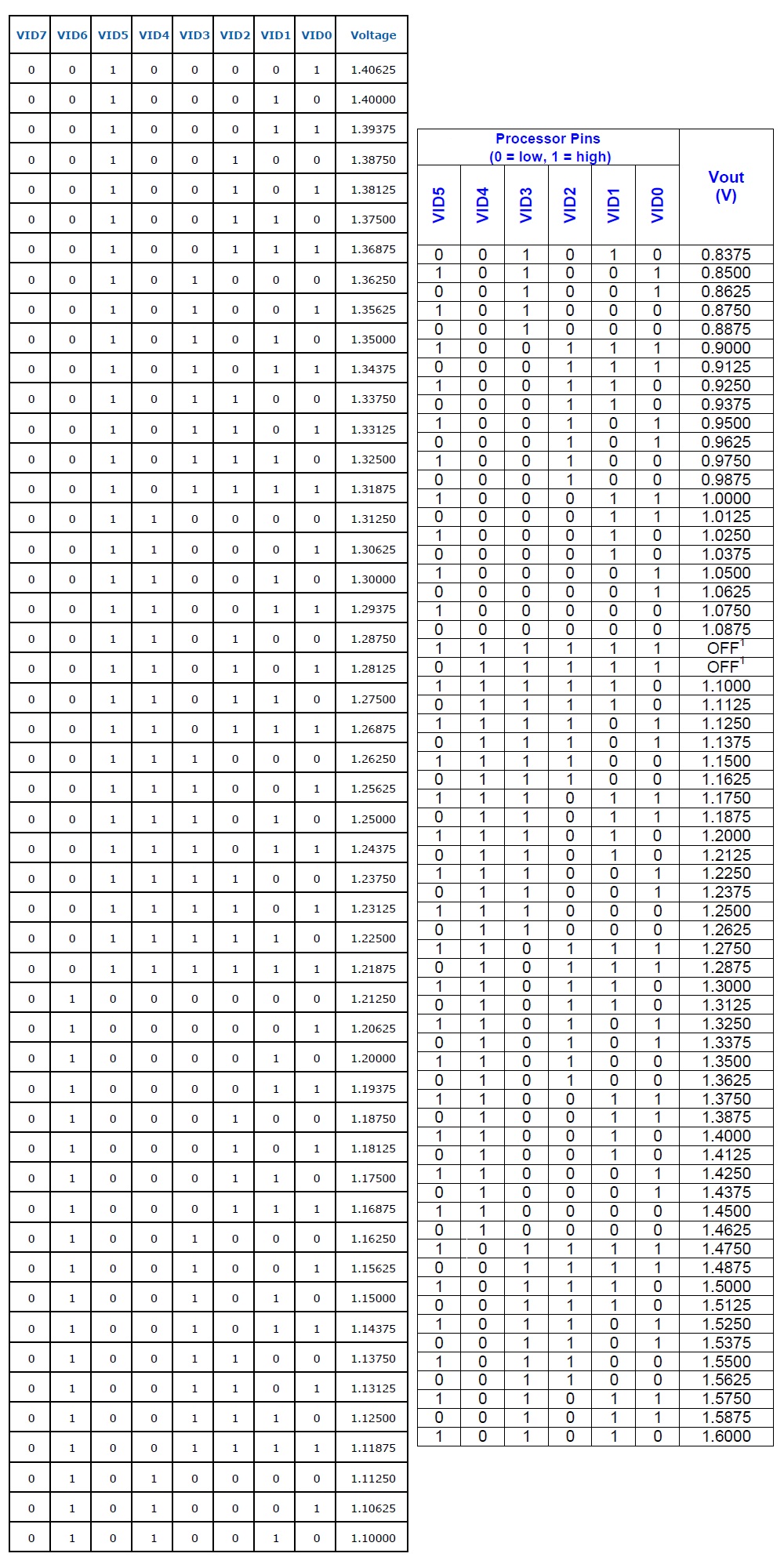

Reply 127 of 171, by dm-
from motherboard side only bios update required.
use standard pin mod for c2d.
do not use conductive pen, solder a thin wire on cpu. (W1V1U1 and C23D23)
but do not connect am1-4+al5-7+ak4,5 - it will set core voltage to 1.08v which is too low.
only isolate VID4 and VID2 pins, it will give you a safe range of 1,1000-1,1625v and 1,2750-1,3625v
table of signals for VRM11(left) and VRM10(right)
awww-picshare-ru_uploads_160110_n31q6uib6u-jpg.99325
