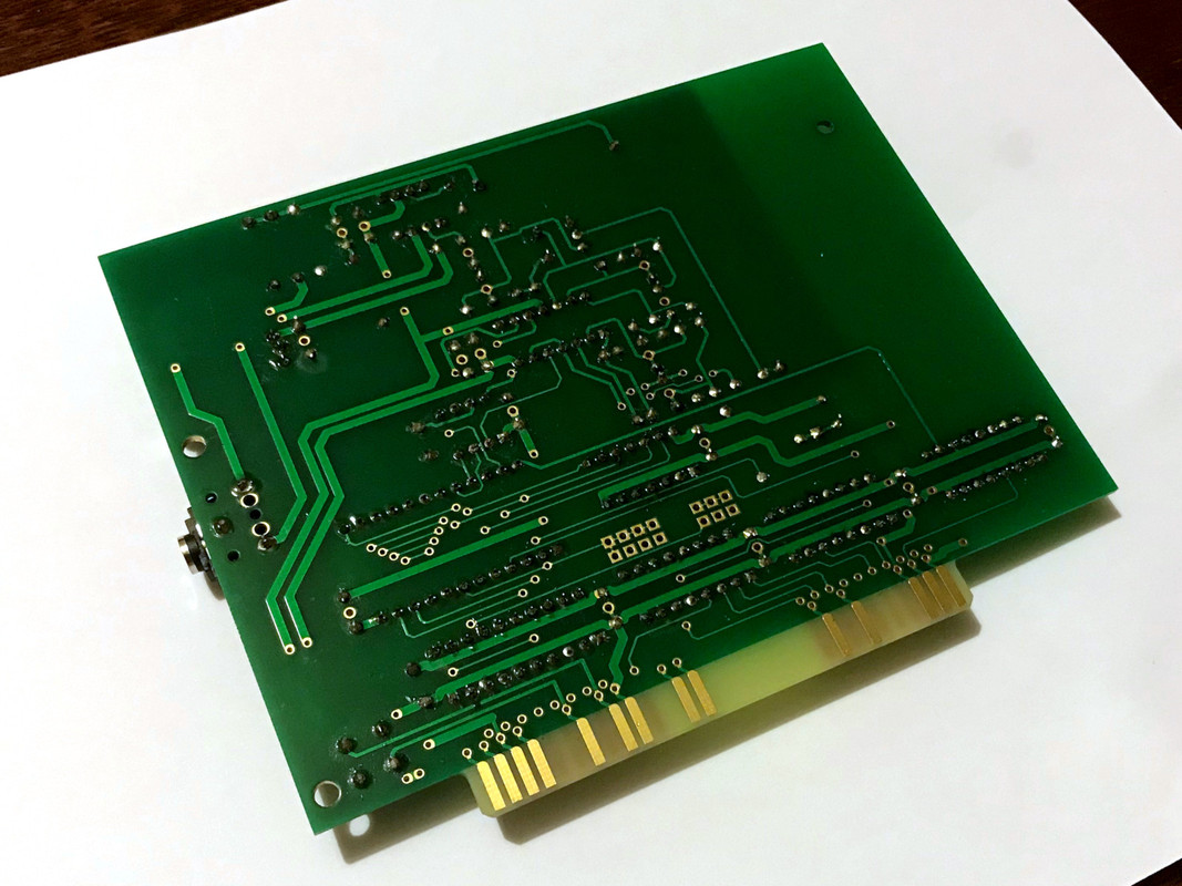

Looks decent from this side. Xiado is right, having a clean work piece is a big part of the job. You can do this by board prep ahead of time and by using flux judiciously. You'll notice when flux is necessary as your solder won't flow properly.
Hershey kiss is a good description of what you're looking for. You want enough solder to flow over the pad or through hole and up the legs of your part while leaving a nice concave fillet. Too much solder will look like a blob over the leg. It's not necessarily a problem structurally or electrically (as long as solder heat was correct and you're not leaving cold joints), but it's inefficient and unsightly.

My solders are mostly ok then I guess. There isnt any solder on the component side on some and the solder is a bit too convex on some but overall Im happy with my soldering.. 😀

You will get better by practice. 😀 The Adlib was also my first major soldering project. I started with some perfboards and some simple blinking LED kits and then ramped up to the Adlib. You will do just fine!
Two hints: use a good temperature. In the beginning I worked too cold. 350°C
Is usually good. Also: clean the tip regularly! Dirty iron tips make bad solder joints. Use brass wool rather than wet sponge, due to thermic stresses.

Unfortunately I just have a cheap 30w soldering pen that isnt temperature controlled as the initial investment for a temperature controlled one was a bit too much; Im feeling kind of confident with what I have now so I would get a desoldering station before I get one I feel.. Or maybe Im just dumb.

Don't be afraid to use more solder than you expect either.
I did the XT-IDE kit a little while back. I had undersoldered a whole pile of pins on ICs, leading to bad connections. So it didn't work at first.
Going over it carefully, fixing bad connections and adding more solder fixed it up nicely. A little too much solder is better for through-hole connections then not enough it seems.
Edit: Some of the solder is actually flux, so that you end up with less volume then you actually melt, keep that in mind too.
You don't have to get fancy with Pace or Metcal gear these days. I'm a big fan of Chinese T15 irons. They can be had for <100 CAD (< 70 USD).

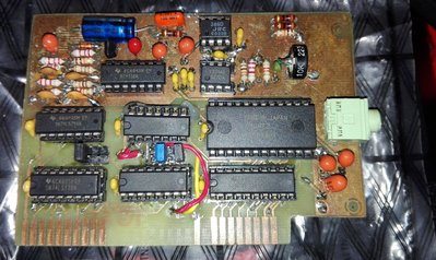

Very nice, i did make an homemade Adlib completely from scratch, long ago,by etching a double sided pcb from Malinov's website. It was a nightmare to make but it costed only about 20 eur in components,including enough spares to make another one.
The attachment IMG_20190620_201821.jpg is no longer available
Yours seems a really faithful replica of the original.
Can i ask where did you get/how did you make that PCB? I might assemble one too, if the price is fair.

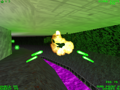

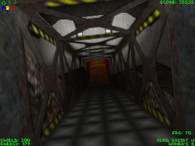

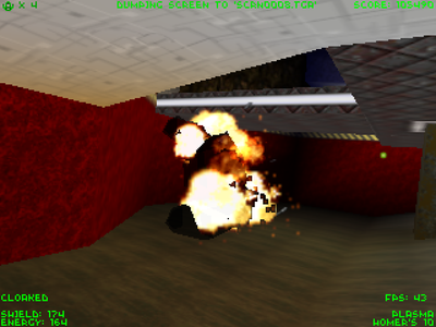

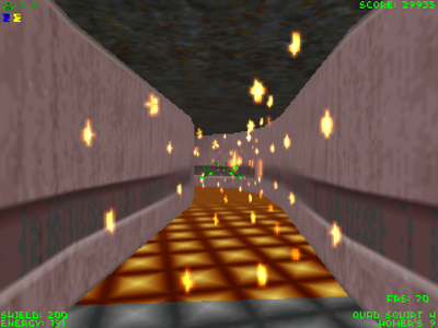

Discovered that, at least as far as version 0.58, D1X/D2X Rebirth (the Descent source port) supports 320x240 & 320x200 modes with the original bitmap assets and all the eye candy turned on. This is a legit 70Hz line-doubled VGA mode according to my monitor info & not some kind of upscaled emulation.
A any rate, it works on my WinXP/GMA X3100 box. Oddly enough, on my "more retro" Win98 machine running D1X 0.56 on a GF3, I don't see the low-res options & am limited to 640x480. Not sure if this was added back in or if it's to do with the graphic drivers.
Playing this way is a kind of surreal experience - the chunky low-res with heavy filtering, plus colored lighting & transparency effects everywhere make it seem like a hypothetical PS2 or Dreamcast port of the game would have looked like. I like it.
The attachment scrn0000.png is no longer available
The attachment scrn0002.png is no longer available
The attachment scrn0007.png is no longer available
The attachment scrn0009.png is no longer available
^^ actual screenshots were 320x240, I upscaled them myself for better viewing
