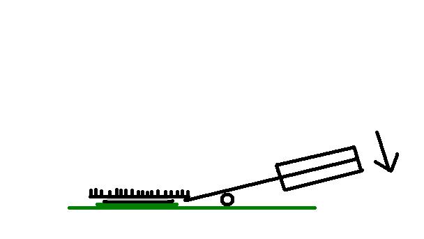

Jade Falcon wrote:
If you freeze the heat sink and or card then that take a screw driver to the card it will come clean off. I done that plenty of […]
nforce4max wrote:
candle_86 wrote:
I'm hoping its a Voodoo Banshee, I think it is […]
Got from ebay
It is and do not try to remove the cooler or you will break it, I had two of this exact card and destroyed one. The thermal epoxy used is very different from the white stuff and it is Strong! Try to remove it and you will crack the plastic encapsulation and kill the gpu. Gateway sold a few of these in their systems but it is made by ELSA (I think) so it is of good quality but still gets scorching hot so just add a fan.
I done that plenty of times on 3dfx cards.
Go ahead I dare you to get this one card yourself and try it, the epoxy used is very different from all the others and it is a dark gray color. Freezing didn't even work 😲
I all ready have on 3 of them, and I am aware the banshee's use a different epoxy.
If it does not just pop off then heat the heat sink up fallowed by a freeze.
If your putting the card in the freezer shame on you :p
