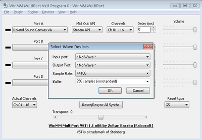

Reply 1547 of 2328, by Roland User
I sets all synths as on screen to Roland
But I not understand as settiings
"Stream API with zero delay is not the same as real-time API at all. In your SAVIhost try to set sample rate to 48000 and buffer size to at least 4800 and you will hear the difference immediately."
this need do in WinMM Multi Port VSTi ? If yes , what for ? This plugin only resend midi messages to VST synthesizers , hovewer , if I use Stream-API , crashed midi resend resend mechanism
Reply 1548 of 2328, by Falcosoft
Roland User wrote on 2023-12-04, 19:28:
I sets all synths as on screen to Roland But I not understand as settiings "Stream API with zero delay is not the same as real- […]
Yes, you need to do this in your SAVIHost with WinMM Multi Port VSTi loaded for testing.
The point is that since it is still a VSTi plugin it gets incoming MIDI messages at the rate of the update period (that you set as buffer size in SAVIHost). This is true regardless the plugin uses audio out or not ( it does not).
So depending on VST host settings real-time API can be good or absolutely horrible. On the other hand Stream API can give you perfect timings regardless of the host/buffer size settings since it can use 'deltaFrames' timestamp info of the incoming Midi messages. The real-time API cannot use this info.
Overall:
The real-time API can be only as precise as the update period. Supposing 48KHz sample rate at buffer size of 240 its precision is 5 ms. At buffer size of 480 its precision is 10 ms. At buffer size of 4800 its precision is 100 ms and so on...
Contrary the Stream API is sample offset precise that is <= 1 ms (always, independently of buffer size).

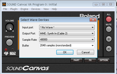

Reply 1553 of 2328, by Roland User
This not work , I not known why (
All what work this 2048 samples or more
I stoped on 8192 samples per 2048 samples per port

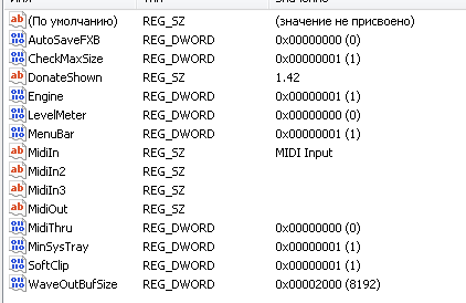

Reply 1554 of 2328, by Roland User
I'm in stupor , if I do that as on attachment - all work stable and not errors , but if I decrease WaveOutBufferSize smaller 2048 samples - all work with bugs. Why ?
Really buffersize need do as summ all buffers for synthesizers or larger ? But not smaller ? Why ? You sayd what Real Time API work at 2 ms , but Stream API need big buffer or this mode so not work as need.
Me need all you sayd about for Real Time API mode , only vice versa if I want this do with Stream API mode.
Reply 1555 of 2328, by Falcosoft
Roland User wrote on 2023-12-04, 23:40:
I do not know what you are talking about. This has nothing to do with WinMM Multiport VSTi. Ask SAVIHost's developer (Hermann Seib).

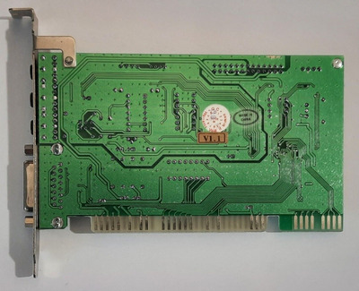

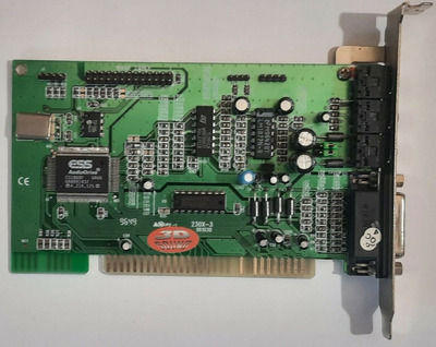

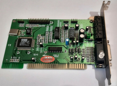

Reply 1556 of 2328, by Roland User
Falcosoft
You include to FSMP plugin OPL3 GM VSTi , and there is some questions :
1) what giving option "Use Dual Synth Mode" and where I can hear diffirence ?
2) whether there is a in plan adding Voyotra SuperSapi mode with drums on 10 channel and not on 16 channel ?
3) whether there is a in plan adding Enhanced ESFM mode ? Especially as this was be in ESS 1868 Melody Sound
I would like to havin ESS1868 emulation as this was be Windows 98 and drivers for ESS1868 Melody Sound ) because this was my second sound card after ESS688 , I remember as good sounded MIDI on this sound card , but I not have old PCwith this hardware )
I owned those what on attachments and first drivers for this card )
