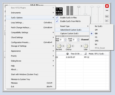

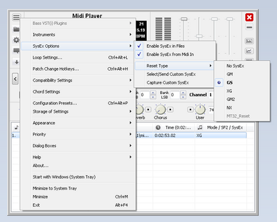

Why MT-32 reset grey ? As activate this reset ?

Roland User wrote on 2024-01-06, 12:29:
I understanded you ) all work as need )
It's gray when it is not available. MT-32_Reset.syx is an external file that should be located within the "SysEx" folder in FSMP's main folder. You should click "Select/Send Custom SysEx" and check that MT32_Reset.Syx is available in the SysEx folder. If it is try to select it again from the list of available .Syx files.
BTW, you can also rigth click the "Reset" button on the right hand side of the player to get this menu. it's a shorter way to set reset related options.
The attachment mt32syx1.png is no longer available
