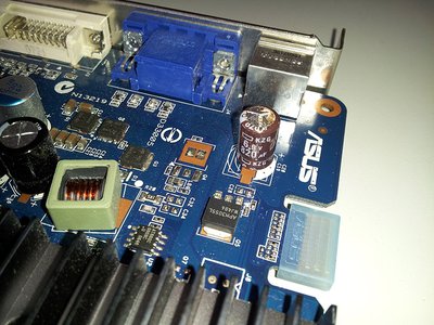

I opened up my 3-way "SLI" machine to change some drives around and found this bit of loveliness inside:
The attachment CameraZOOM-20191018115035214.jpg is no longer available
Yeah yeah, leaky cap on a 2008 GPU. Big whoop. The thing is, I only built this machine about two months ago and it looked completely fine when it went in, so this was recent. I've run across a lot of stuff where the caps went bad in the past, and that seemingly took years of use to manifest. I've never had one go bad over the span of a couple months of moderate usage in my possession.
Granted, I did just about everything "wrong" in this build - bad airflow, shoddy cable management, inadequate cooling - and you could probably argue the cap was ready to go even if it wasn't bulging when I put it in. I didn't really make this machine with the intent of keeping it together for very long. But I also haven't used it that much, just a few ~1hr long gaming sessions and some benchmarking. This card was in the very bottom slot running PhysX, and it did get hot with the big passive cooler.
Still, it looked perfectly fine 2 months ago, and now it doesn't.
Fortunately it's pretty easy one to replace, and the other caps on the card "look" fine, so I'm just gonna leave those alone unless I need to.

Reply 161 of 1805, by TheMobRules
@xjas, that blown cap is Chemi-con KZG, a series that is infamous (along with KZJ) for being almost guaranteed that it will not last long, especially on warmer environments. ALL the KZG capacitors in my mid-2000s boards have failed.
I recommend you replace all KZG caps on your card, even if they look fine.
Reply 162 of 1805, by xjas
Thanks - yep, figures. I've run into blown KZGs on other stuff too. The others on the card are Nichicons.
It's "just" an 8500GT, but I find it's a useful card to have around for test rigs or bench setups, so it's worth repairing to me.

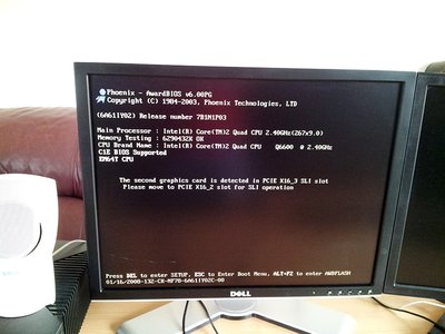

Reply 164 of 1805, by xjas
FOR FUCK'S SAKE.
The attachment CameraZOOM-20191018132436789.jpg is no longer available
^^ it won't let me boot after this. Hard stop, doesn't initialize the USB controller, no response to PS/2 keyboard input or anything.
This is LITERALLY the same configuration it was in an hour ago, just with the 8500GT (which was ONLY being used for PhysX) removed. The same two "main" cards, connected by the same SLI cable, are in the same slots they were always in. For some utterly inane reason, they ordered the slots 1-3-2 on this board so if you're only using two cards you need to leave the MIDDLE one open. Well, I don't have a long enough SLI cable to stretch from the top to the bottom slot, so NO BOOT FOR ME.

Reply 165 of 1805, by agent_x007
That's why I prefer to use later platforms for SLI (1366/2011).
PCI-e hardware disable switches 😁
Maybe turn off USB ?

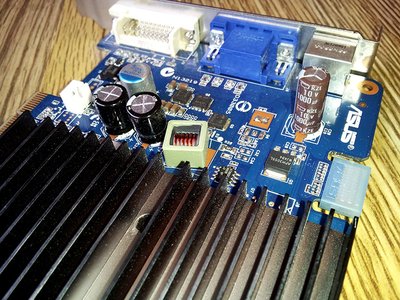

Reply 166 of 1805, by xjas
There, I fixed it. 😠
The attachment CameraZOOM-20191018143024722.jpg is no longer available
(Which actually took way longer than it should have, because I didn't realize my "45W" soldering iron couldn't get hot enough to desolder the ground side pin no matter what I did. After I switched to a "35W" iron, it came off instantly. The "45W" one went in the bin.)
And yes, I used a 1000µF cap in place of the 820µF one. #YOLO.
In hindsight, I probably should've just yanked the SLI cable or even the second card, but hey, now the system is back to 100% functionality again & I didn't have to mess with Windows's driver weirdness, so FINE, IT'S FIXED FOREVER. DONE.
Reply 167 of 1805, by oeuvre
Woo nice work! Glad the PCIe slot issue went away too

Reply 170 of 1805, by xjas
Thanks! At least it's done so the card doesn't have to sit on my shelf of shame.
As far as I can tell, the PCIe slot thing was just a completely made-up hardware lockout. Once I put the 8500GT back in slot "2" (on the bottom), it let me boot, even though that card barely gets used in any application if SIV's load monitor is to be believed. I hate that crap. I thought PCIe was supposed to be slot-agnostic?
