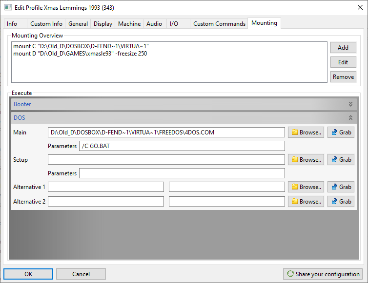

Reply 1706 of 2228, by dor123
I've problem when importing D-Fend Reloaded profiles to DOSBox Game Launcher: The main folder of the games profile is "D:\Old_D\DOSBOX\D-Fend Reloaded\VirtualHD\FREEDOS" instead of the game folders:
So I need to pass every profile and correct the main folder and file to the game file.
DOSBox 0.74-3
D-Fend Reloaded 1.4.4
DOSBox Game Launcher v0.97
DFendX 2.5.0
Windows 10 Enterprise 64-bit version 22H2
Reply 1707 of 2228, by rcblanke
dor123 wrote on 2021-08-29, 08:52:
I've problem when importing D-Fend Reloaded profiles to DOSBox Game Launcher: The main folder of the games profile is "D:\Old_D\DOSBOX\D-Fend Reloaded\VirtualHD\FREEDOS" instead of the game folders...
Hi dor123,
Generally speaking, DBGL will try to keep the paths like they were in DFR. If you had your DFR games located inside "D:\Old_D\DOSBOX\D-Fend Reloaded\VirtualHD", DBGL will also use that location. What you can do with DBGL after importing the DFR profiles, is to use the 'migrate' function (Profiles -> Migrate profiles). Enter "D:\Old_D\DOSBOX\D-Fend Reloaded\VirtualHD" as "From" location and let DBGL process all profiles. After this, move all your games into DBGL's dosroot folder and you're done.
Having said that, your use-case seems a bit different, as you seem to have 2 paths configured?! Are all your games actually located inside D:\Old_D\GAMES ? And were they as such configured in DFR? Maybe you can share a screenshot of the paths configuration in DFR? I guess this problem might have something to do with using 4DOS...

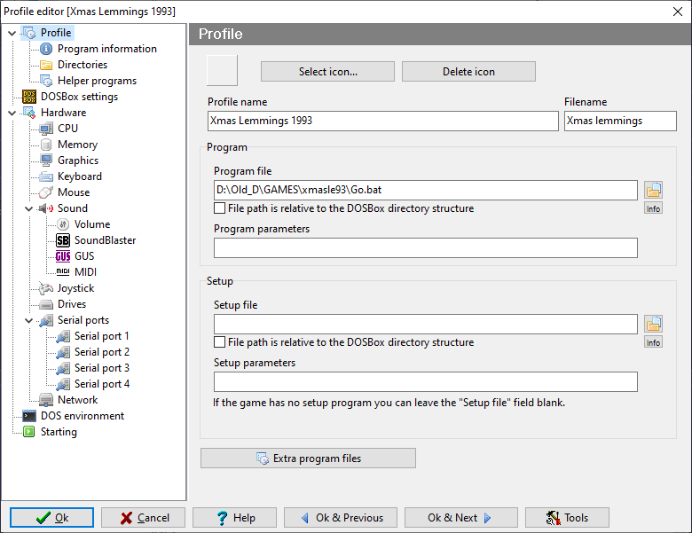

Reply 1708 of 2228, by dor123
All of my games located on D:\Old_D\GAMES\ and they were configurated such in DFR:
DOSBox 0.74-3
DFendX 2.5.0
