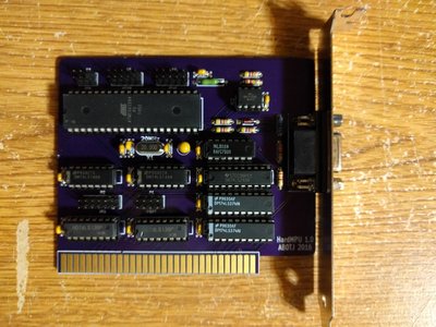

Look guys, I made a thing.
Reply 182 of 618, by TheMobRules
Looks fantastic ab0tj! 😲
I've been reading the entire thread and it's nice to see everything coming together! Kudos for your work.

Reply 187 of 618, by ab0tj
matze79 wrote:
will you offer Kits ?
That's the plan... Need to do some testing first, though.
stamasd wrote:
Excellent. Does it work?
I actually don't know yet 😁 I finished soldering it together last night, need to program the micro and test today.
Reply 188 of 618, by ab0tj
Good news, everyone!
It works! Now comes the fun part... Testing it with every game I can think of.

One small error that I will need to fix before ordering more boards though, it seems that the DE9 footprint I used is reversed for some reason, so the cable will need to be built with a mirror image of it's pinout.

ab0tj, the USER header... looks like it's connected to the second UART of the Atmega1284, where the actual external MIDI port is connected to the first UART (as expected). Are the signals on the second UART of the MC duplicated to/from the host (i.e. are the signals sent and received on the second UART identical as on the first) or would this require some customization of the firmware loaded onto the Atmega?
Reply 198 of 618, by ab0tj
Right now the firmware does nothing with the second UART. It wouldn't take much to add an option to the config utility that switches the midi output to the second UART (or both).
