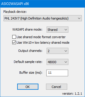

10. Besides WaveOut the driver now also supports ASIO output. There are ASIO drivers that are either 32-bit or 64-bit only
and 32-bit config dialog does not necessarily enumerate the same ASIO drivers as the 64-bit one and does not reflect what ASIO drivers 64-bit clients see.
(E.g. on 64-bit OS Steinberg products typically install "Low latency Generic ASIO driver" that is 64-bit only).
FSMP has no ASIO output support so there is no such problem. If you do not use ASIO then you can use either the 32-bit or the 64-bit config utility, they do the same.
An example (as you can see the same selected driver is available at different Ids on 32-vit vs. 64-bit):

Reply 196 of 262, by Falcosoft
Hi,
If someone is interested I have forked the abandoned ASIO2WASAPI project on GitHub to make a private plugin for VST MIDI driver but at the same time I have also updated the main branch so some useful features added to the full ASIO driver and I have also made some important fixes. The driver now supports WASAPI shared mode besides exclusive mode and if sound card driver suppports it Windows 10+ special low latency shared mode can also be used with the driver.
So comparing e.g. to ASIO4ALL when shared mode is used you can still use other audio software even if the ASIO driver is active.
New features/fixes:
1.Fixed supported format query.
2.Fixed non modifiable 100 ms latency problem.
3.Fixed too quiet rendering in case of supported 24-bit PCM format.
4.Count of supported channels is calculated automatically.
5.Supported sample rates are calculated automatically.
6.Added support for default device. Driver can restore itself when default device or audio properties are changed in Windows.
7.Added support for WASAPI shared mode
8. Added Win10+ special low latency shared mode. (This mode needs proper drivers. Usually proprietary vendor drivers from Realtek, NVIDIA etc. do not support low latency shared mode. But generic High Definition Audio driver from Microsoft does support it on Windows 10/11.)
9. Added version info to ASIO control panel.
https://github.com/Falcosoft/ASIO2WASAPI/releases
The private plugin version of ASIO2WASAPI will be included in the next release of VST Midi Driver and an option will be added to the setup dialog to use only the ASIO2WASAPI plugin and ignore other ASIO drivers on the system. This way those users who have problems with system wide ASIO drivers can also use the plugin to get WASAPI output modes.
It would be useful to get some feedback about how the full plugin is working before adding it to VST Midi Driver. Thanks in advance.
The full ASIO driver linked above works with the current VST Midi driver so the tests can be done with it.
Just click Install.exe after unzipping the package of ASIO2WASAPI and the next time you start VST Midi driver configuration utility ASIO2WASAPI should be present on the list when you select ASIO output mode (of course make sure you installed VST Midi driver with the ASIO option selected).
