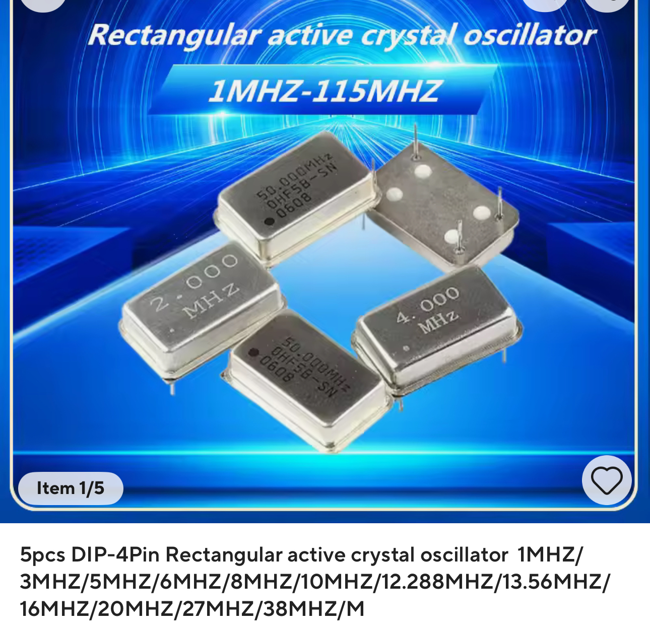

Reply 22 of 39, by PD2JK
I wouldn't go higher than 25MHz. There are 12.5 MHz clocked 286 CPUs, it could be feasible.
Both your pictures are 4-pin, so either is good.
