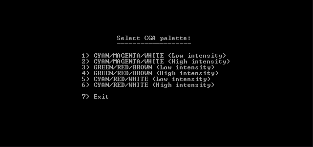

Reply 26 of 27, by Revolter
There are some CGA games - such as BurgerTime, PopCorn and Grand Prix Circuit in CGA mode, - that just ignore the palette changes made by this utility (there is a routine that's supposed to suppress that, but it only works with EGA- and certain CGA titles for some reason) on VGA cards, but I've fixed it so that they don't 😀 Very handy for PCI & AGP cards that do not emulate CGA color palettes properly (which is 99,9% of them).
There is now a glitch that breaks DOS Navigator's graphics (possibly others), but it works wonderfully otherwise: just use the command line in pure DOS, or restart the PC between sessions.
I've also included a little batch file menu for loading the standard CGA palettes:
menu-png.322731
In all other aspects it works exactly the same as the original version of CHGCOLOR.
