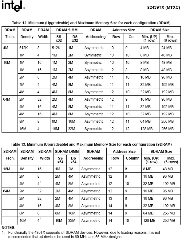

I'd be interested to know if your 430TX system will even boot with 256MB RAM (128MB x 2) and 83 MHz FSB. Mine would not. It needs 1 stick of RAM to even turn on at 83 MHz.
I put in a second 128MB DIMM module and ran some tests. The system starts without problems (K6-III/400AHX, family 5 stepping 9 model 1, 83MHz, x5.0 ==> 415MHz), but only recognizes 192MB, probably because the memory sticks aren't identical.
But apart from that the system seems to be stable: I ran Unreal without crashes, ran memtest for two hours without any errors reported. I also successfully compiled a Linux kernel and ran some OpenGL applications under Linux. This is usually a "safe" way to test if your system has a problem: If a kernel compilation stops with the compiler segfaulting, there is most certainly something wrong.
Was it repeatable? My symptoms of crashing were very unpredictable and seldom occured.
Yes, more or less. In Unreal it did not crash immediately and never at the same spot, but the crash occured within a few minutes of gameplay.
Reply 24 of 40, by Tetrium
That sounds like your second stick of RAM is of a too high density for your board.
I'd bet that if you put in just that one stick of 128mb, your system will only see 64mb 😉

Reply 26 of 40, by feipoa
DrSwizz wrote:
This old board can use 83MHz FSB and is quite stable at that frequency. It accepts 256MB DIMMs too. :-)
Could you test your system with 2 sticks of 128 MB and 83 MHz? There is a caviat in the 430tx manual about using a single 256 MB module. Is the stick being treated as x4? Remember, double sided DIMMS constintute 2 rows, as if you had inserted 2 single-sided modules.
