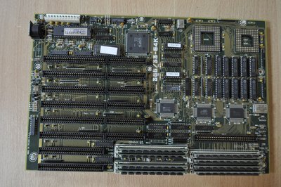

Reply 23 of 28, by 4xtx
Scored one of these boards today, it came out of a rusty portable PC and had a lot of muck and dust (see the CPU).
Ordered some new caps as I can see a few are damaged, hopefully she POSTS after a recap and tidy up 😀
I am going to do a thread on the luggable but if anyones interested its the Scantech LCD-386 or variant.

Reply 27 of 28, by scorp
Hi guys, I just got the very same Asus 386/33-64k mainboard. It's seems to be dead. Someone already soldered here and there and an IC was missing. I got the IC back in place, but the board still seems to be dead so far. My suspicion was that the BIOS is not the original one. Since you can clearly see "386 BIOS HI" on it. I thought HI? And where is LOW? This didn't seem right to me, so I searched the net and stumbled over this thread. And what do I see?! @4xtx posted a picture with the BIOS label "386 BIOS HI" as well. Now I'm quite confused. It can be barely a co-accident, that we both have wrong BIOS Chips with the same label. So I guess "386 BIOS HI" must be just a misleading label? Does one of you guys have this mainboard POSTing? And could you please put your ROM image here, so we can upload it to the UH19 project? That would be great!

Reply 28 of 28, by 4xtx
scorp wrote on 2021-02-28, 13:28:
@4xtx posted a picture with the BIOS label "386 BIOS HI" as well. Now I'm quite confused. It can be barely a co-accident, that we both have wrong BIOS Chips with the same label. So I guess "386 BIOS HI" must be just a misleading label? Does one of you guys have this mainboard POSTing? And could you please put your ROM image here, so we can upload it to the UH19 project? That would be grate!
Will do 😀 I feel like I have many submissions overdue on that project.
With regards to the BIOS; it is very scaled back and only has boot priority and configuration.
It also does this weird thing where the font colors seem to persist once DOS starts until you CLS
While I don't mind the blue background it would be nice to not have it there as a default.
Also just so you are aware - my board came out of a portable PC that identifies as "Scantech LCD-386"
It is unique in that it accepts a standard AT board and came with ISA VGA with some sort of LVDS driver on it (scorp - you had a similar one on your YT which I commented on) I had to replace most of the tantalums but otherwise the board was OK (External battery!)
Unfortunately I cannot restore that unit as it had a very high voltage board inside the (extremely compact) PSU which has exploded due to previous damage.
That board drives the LCD interface which is really a poor display anyway..
