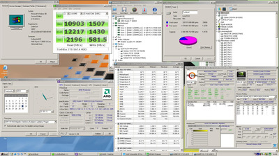

Reply 27 of 33, by darry
elszgensa wrote on 2023-09-03, 09:27:
darry wrote on 2023-09-03, 05:59:
I have used over 500MB
I'll assume that's a typo, both because you wrote gigabytes in the other thread and because half a gig is a total noissue in any but the oldest machines anyways. Or did you go for such a machine specifically, trying to poke around the 504/528MB BIOS limits?

Even back in ye olde times 4TB was the theoretical.
In reality Windows 98se had an fdisk limit of 64gb and ide controller limits of 128gb.
3rd party utilities let you break the barrier, historically I had a 160gb hd under 98
Reply 32 of 33, by DarthSun
rmay635703 wrote on 2024-06-04, 18:44:
Anno, I was tense to 98 because it was widespread that it was not running with a big clock, I thought it came with folk belief, with modernizing machines+many RAM when it stopped over 512MB. Then it turned out to be a prime in @4650MHz, of course, a lot of RAM needs the Loew MEM-DRIVER.
