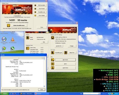

C. 3d mark 2001:
Reply 21 of 1162, by nd22

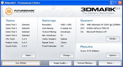

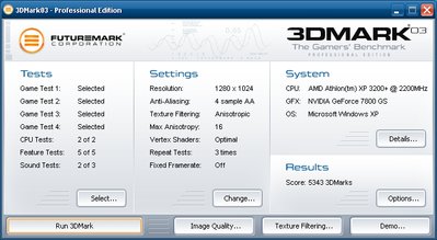

D. 3d mark 2003; by now the CPU limitation is gone and the GPU is the one which is limiting the performance of the system:
Reply 22 of 1162, by nd22

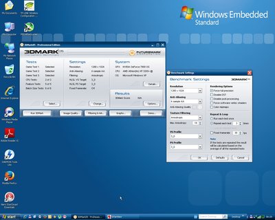

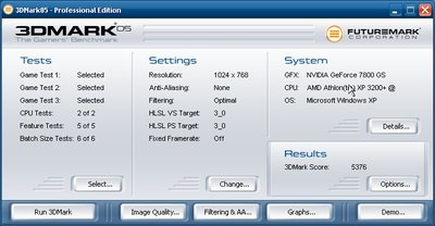

E. 3d mark 2005 - the GPU is the bottleneck now and the results are provided more for your information than for any useful purpose - 7800gs is clearly not suited for 3d mark 2005; the settings screenshot provides information about what I meant by " maximum settings":

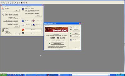

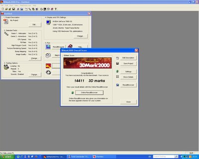

Reply 31 of 1162, by nd22
First of all I must state that I will not ever overclock my retro systems! Long life and stability is far more important!
Second of all the benchmarks represent the same CPU/RAM/GPU combination and only the chip-set is different so no Intel bias here 😊 !
Now back to the test with the NFORCE2 platform represented by the Abit AN7 motherboard:

B. 3d mark 2000 - as you can see increasing the resolution will result in a lead for the KT880 platform despite nforce2 being faster at 1024*768:

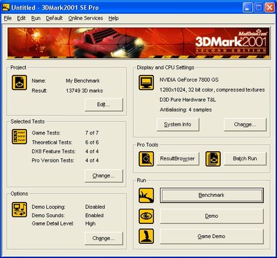

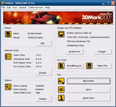

Reply 33 of 1162, by nd22
C. 3d mark 2001 - nforce2 dominates this DirectX8.0 benchmark by great amounts at lower resolutions:

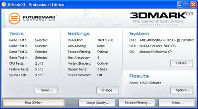

D. 3d mark 2003 - it's a tossup here because the video card is already bottle-necking the system:

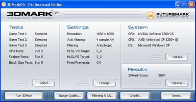

Reply 35 of 1162, by nd22

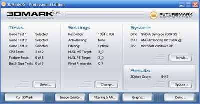

E. 3d mark 2005 - again too close to call because the video card is overwhelmed in this test, a geforce 8800 or better is required:
I am sorry for the lack of result at the 1680*1050 resolution; it seems I forgot to make the screenshot 😊 but the results are really close, within the margin of error!

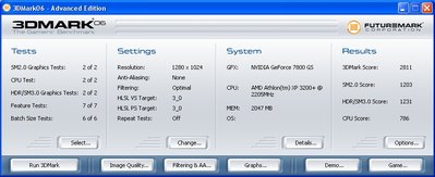

Reply 36 of 1162, by nd22
F. 3d mark 2006 tested out of curiosity and the result confirm that 7800gs is no match at this level:
