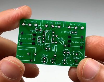

Reply 25 of 53, by Intel486dx33
You can create and have fabbed your own surface mount pcb. 10 pieces for $10. Then just solder all your connectors to it.
https://youtu.be/g4iiekExXak

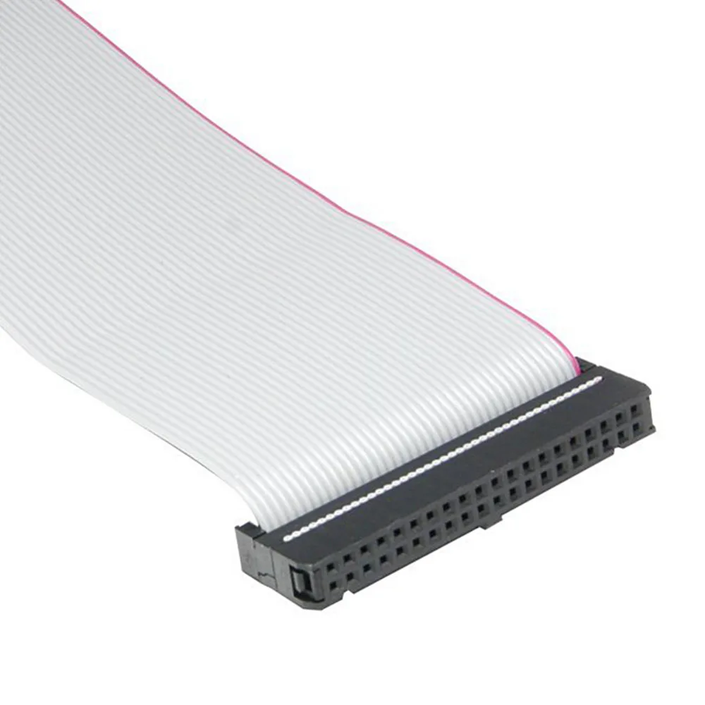

Guys, please if someone could help me with the flat cable from the X-Fi Platinum (the front panel to soundcard ribbon cable). I've lost mine, could I replace it with an 50 pin SCSI cable? Did anyone know something about it? Thanks in advance!

w0lf42 wrote:
IDE cable cant fit on the X-Fi because of the blocked pin.
The 50 pin SCSI has no blocked pin however. Do you think it will fit on the x-fi case (the front panel case i mean)?
Reply 30 of 53, by w0lf42
I'm not sure what you mean by blocked pin. Perhaps I just don't understand, but from the image on wikipedia, i looks it just has two absent pins:
Reply 33 of 53, by w0lf42
I might be wrong here. But are we talking 40-pin versus 80-pin cables? Yes, the connector might be 40-pin for both, but the cables aren't both 40-pin.
I did a quick ebay search and each 40-pin cable does not have a blocked pin. But, all of the 80-pin cables do.
Reply 34 of 53, by PARUS
w0lf42, )))))))))))))) And you're wrong! 😜
https://bilder.tragant.de/produkte/orig/5110e … 66.01246684.jpg
Most of late 40-wires cables have a key too. I think Cosmonal just haven't found a cable without key.
Cosmonal, yes, 50-pin SCSI cable suits. But do it very carefully, don't make mistake. I mean a cable shift on 5'25 Ext connector relative to main card's connector.
Reply 36 of 53, by Cosmonal
Thanks for the replies guys. I've found an older IDE cable seller here in Brazil. Will try first with the SCSI cable (it's already on the way), if it doesn't fit I'll get and older IDE cable without the key. Thanks Parus and everyone else.
