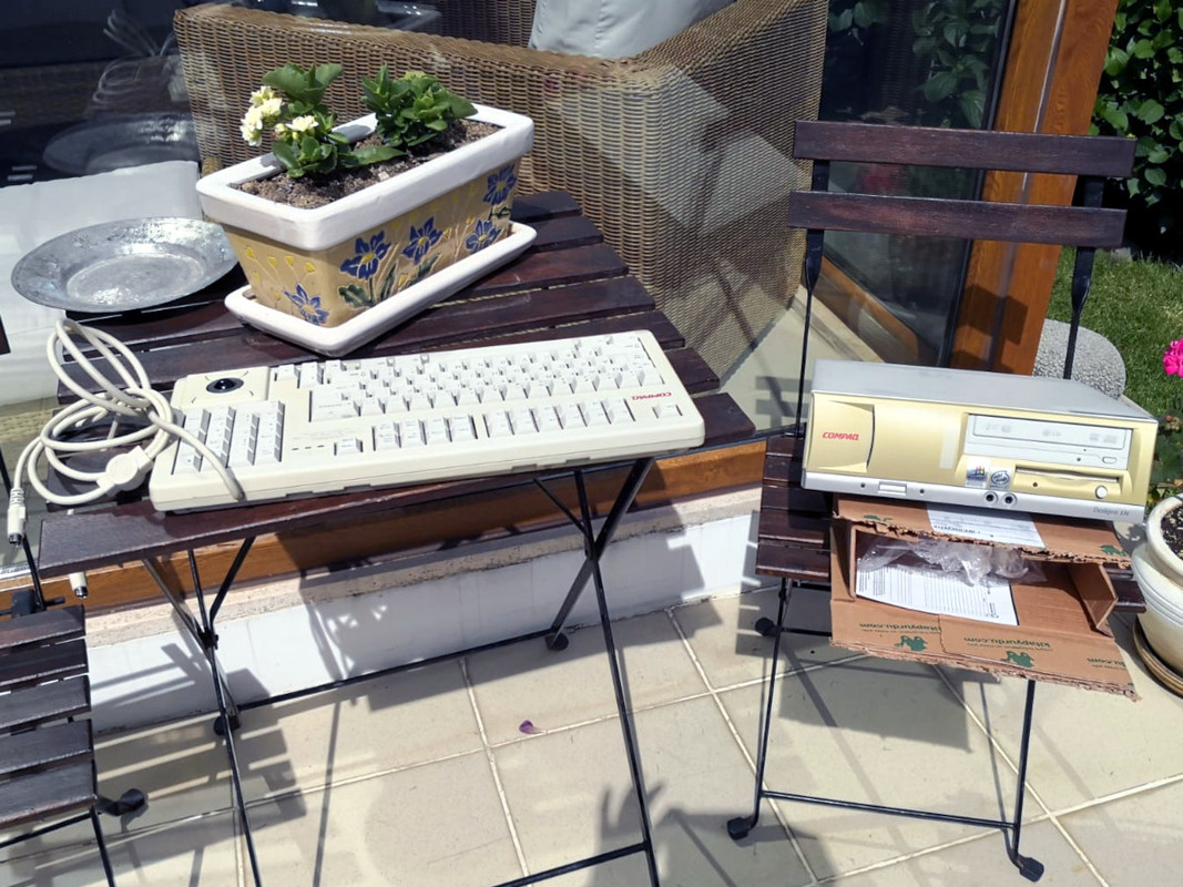

I've done some experimenting myself. Judge for yourself.
Day 0: Yellow keyboard plastic, white keys. Sickly yellow case front panel.
Day 1: After one full day of lightbrighting, the keyboard's plastic appears to be bleaching, the change in the case is subtle.
Day 1 End: After second full day of lightbrighting the keyboard and keys are all the same nice white color. The case front is starting to bleach, the contrast between where the stickers were and the rest of the front is starting to decrease.
It certainly works, and I will keep bleaching this case to see how far it goes. I will also start bleaching my K6 case soon as well.
