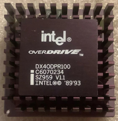

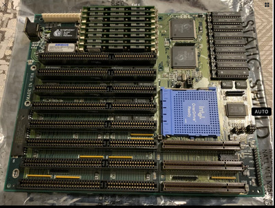

Okay, since I could not get the Gigabyte motherboard to work ( has cache chip socket problem )
I have decided I to use my 1993 “Made in USA” 486 motherboard.
It’s a “Vega VS486F-3VL” Motherboard ( Young Micro Systems inc ).
http://www.elhvb.com/webhq/models/486vlb3/vs486f.txt.html
I am going to use it with a 486dx-4-100 Intel Overdrive CPU from 1993
Reply 21 of 217, by lemonlime
Very nice build!
I've been keeping an eye out for one of those DX4-100 overdrive chips for a long time. My board only takes 5V CPUs and that has a built-in VRM for 5V-3V down-stepping, which is great.
Also known as vswitchzero. Check out my YouTube channel: https://www.youtube.com/c/vswitchzero
Reply 22 of 217, by Intel486dx33
lemonlime wrote on 2020-01-23, 21:36:
Very nice build!
Yeah, this CPU will work. Just set up your motherboard jumpers for a 486dx-33 CPU and then insert the Intel overdrive. It will take over at 100mhz..

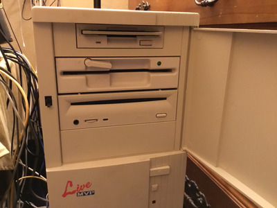

The build is coming along great.
I have all the hardware installed and working.
I am completing the installation of DOS/Win311 now.
I had a problem with the 4x tray loading CDROM I originally selected. It did not want to read the CD’s.
So I found this Sony 8x slot loading CDROM in my garage.
What do you think about It.
Is it too NEW ?
It works great but it is NOT 1993/94
What should I do ?
All the rest of the Hardware is 1993/94

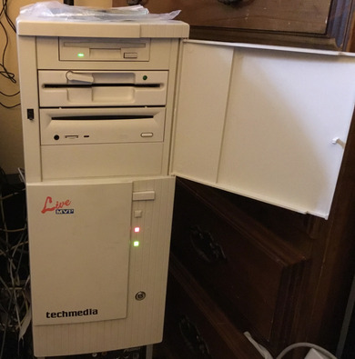

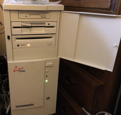

Reply 24 of 217, by Intel486dx33
Just about done with this build.
It’s the best 486 computer to date that I have assembled.
I just need to do some cable management and cleanup the case a little.
Looks great and performs good.
Run quiet too.

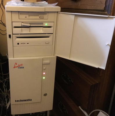

Reply 26 of 217, by Intel486dx33

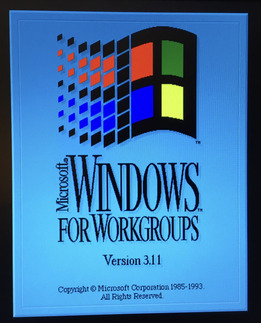

I have it all working. All the hardware works and all the software works.
I am going to name this a 1993 build with DOS 6.22 / Win311 from 1993.

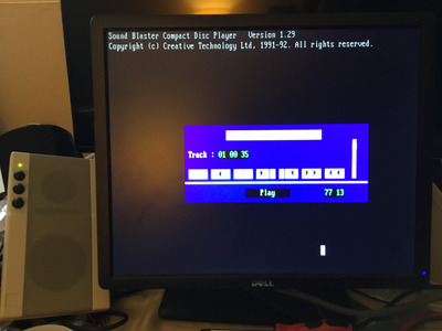

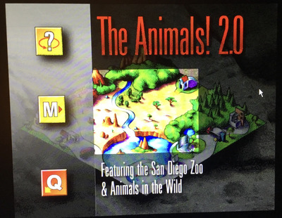

Reply 27 of 217, by Intel486dx33
Computer is working great.
Runs smooth.
Sound Blaster 2.0 audio sounds great with these Advent 2,1 speakers.
Computer works much better with this 8x sony CDROM player. Disk load quickly and play smooth.
Would have been nice to have back in 1993.
The computer I had back in 1993 was just too slow to be a Multimedia computer.
I think software developers were pushing the Multimedia content when the computer market was NOT ready.
Same thing happened with the Internet. The computer user population was just NOT ready.

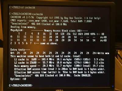

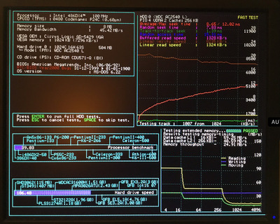

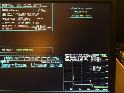

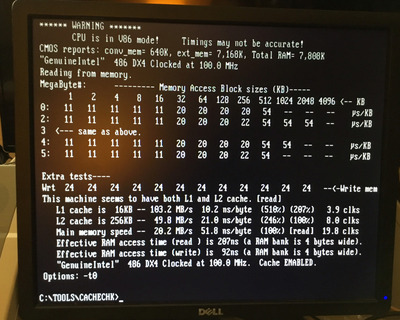

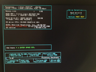

Reply 30 of 217, by Intel486dx33

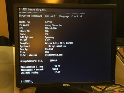

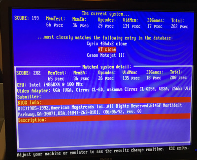

derSammler wrote on 2020-01-26, 20:54:
Intel486dx33 wrote on 2020-01-24, 21:51:
Memory speed, especially L1 and L2, seems very low for a DX4-100.
Here, I ran the tests again using conventional memory setup.
The first test were run using extended memory setup.
L2 cache score is a little better.

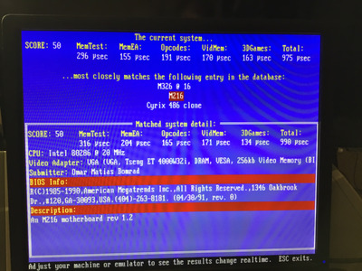

Reply 35 of 217, by Intel486dx33
Using the turbo switch and Setmul utility i am able to slow this computer down to a 286@20mhz. For playing old games.

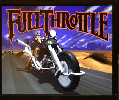

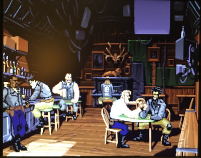

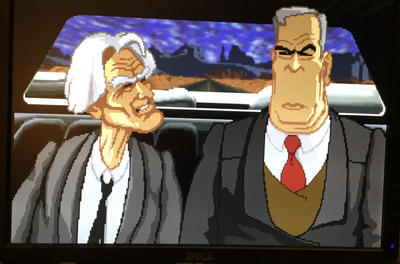

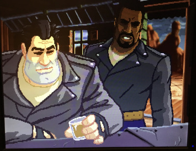

Reply 36 of 217, by Intel486dx33
Plays “Full Throttle” good and sounds great.

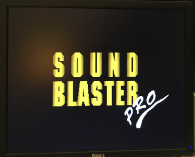

Reply 39 of 217, by Intel486dx33
boxpressed wrote on 2020-02-01, 18:59:
Intel486dx33 wrote on 2020-02-01, 18:26:
Any ideas on how i can make this a better 1993/94 computer ?
LA or wavetable synthesis. MT-32, GUS, or high-quality GM sound card/daughterboard (preferably all).
The Sound Blaster Pro already has a Yamaha YMF chip.
It does not have a connector for a daughterboard.
I would have to get something like the Edison Gold Sound card for that.
