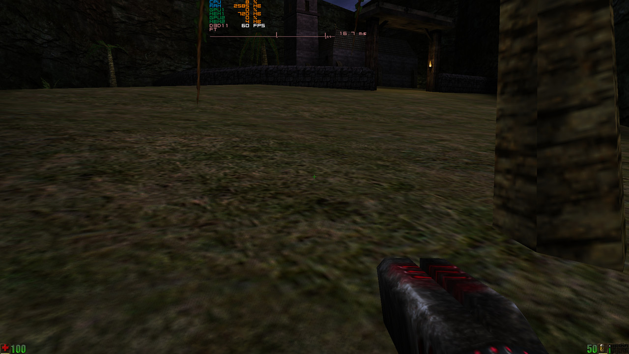

And about Chaos Theory? Why your patch fixes the black screen too?
TBH, I don't have a clue... 😁 I forgot about the fact that I silently used my patch when testing this game.
I gave it another go with the unpatched exe and it just crashed for me, as expected.

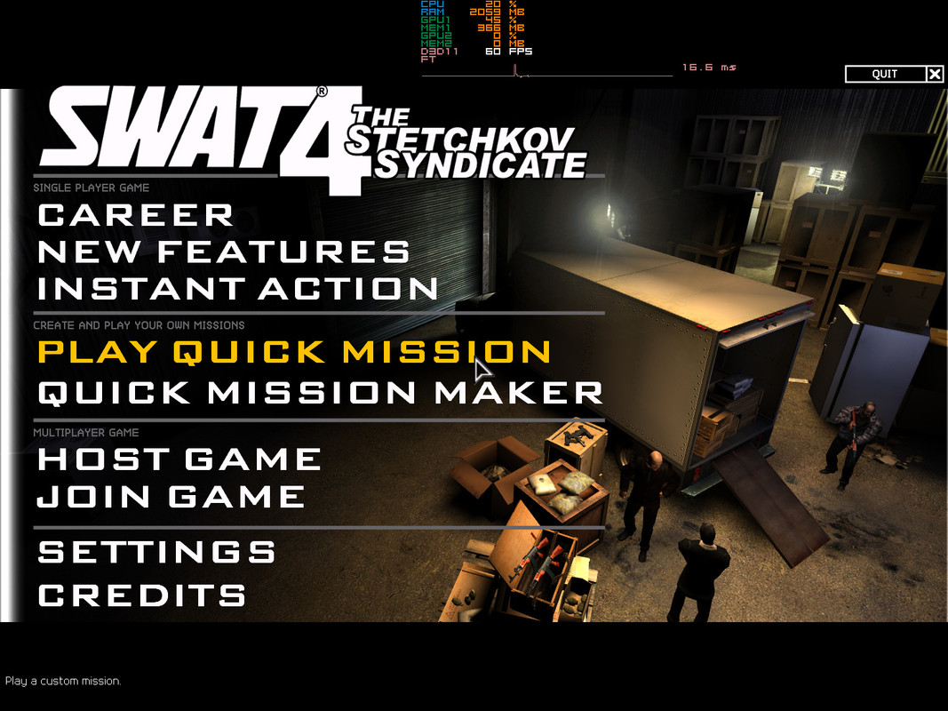

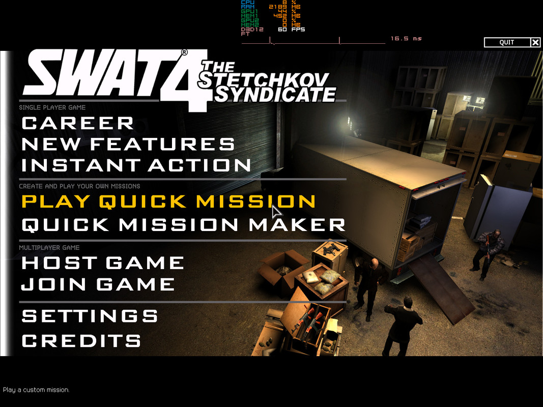

As for the timeframe: both with D3D11 and 12 it's quite smooth for me. Not perfectly, like a dead's ECG and D3D11 seems to be a little bit more noisy in the menu.
But I don't really understand what frametime measures exactly: if it's vsynced to 60fps then frametime why isn't just constant 16.6ms? And how can it intermittently spike over, into 17.x ms?

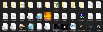

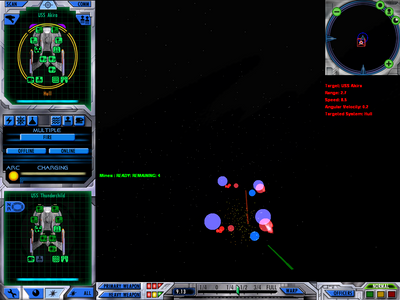

Wondering if any of your fixes noted on this post, might solve an issue I myself and others have encountered in the past few months with recent Starfleet Command 3 installs on Windows 10 devices that have DirectX 12. I installed the Microsoft DirectX® End-User Runtime update that Mircosoft claims back-fills for any missing drivers, but it doesn't appear to have fixed the problem and/or DirectX 12 just ignores it. From what I've read, it seams DirectX 12 doesn't support older games at all. If the above zips could fix the issue (see below), what files and where do I drop them specifically? Do I need to put them in both the 64 and 32 bit folders on my system?
To clarify, the game after I install plays fine (full screen, etc.). The issue I'm having specifically, is that the texture renders are incorrect or non-existent; no apparent loading of the textures from the "Space" folder, weapons/shield effects have muted tones and the ship renders are missing. Strange thing is, if I copy over my mod files to replace the Taldren Assets/MetaAssets the ships show up, but still stuck with the other texture issues.
This is what I get after installing SFC3, the Taldren patch, the Starfleet Command 3 HD&Gamespy Patch https://hotandspicyforums.com/starfleet-comma … tch-t18931.html, and the dgVoodoo2 files: D3D8.dll, ddraw.dll, dgVoodoo.conf everytime I play:

What I have in the game directory for your review:

Reply 39 of 474, by yochenhsieh
AlDaja wrote on 2020-07-24, 00:27:
This is what I get after installing SFC3, the Taldren patch, the Starfleet Command 3 HD&Gamespy Patch [https://hotandspicyforums.com/starfleet-comma … tch-t18931.html[/url], and the dgVoodoo2 files: D3D8.dll, ddraw.dll, dgVoodoo.conf everytime I play:
Hi
I don't see d3d8.dll in your folder. Did you copy to the right place?
And I recommend move dxgi.dll to other place to disable Reshade for testing.
