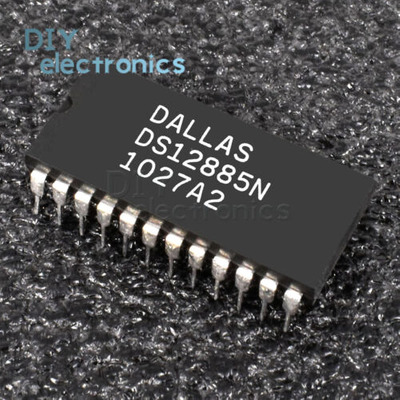

Not a module as such. Just a RTC IC
maxtherabbit wrote on 2023-02-20, 03:34:Not a module as such. Just a RTC IC
Exactly this. Many boards have traces to support the DS12885, an external 32768Hz quartz crystal and a CR2032 battery option, but that option is almost never populated. I half-converted the DS12887 into a DS12885: The modded module uses an external battery, but it still uses the internal potted quartz crystal.
