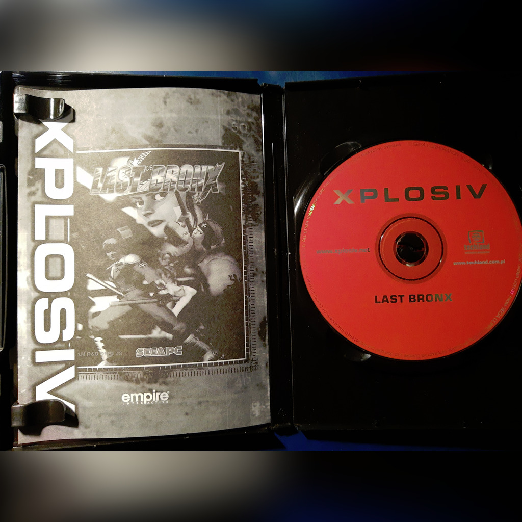

Ok, I fix this, but it's weird, very weird. I installed game from original cd and exe from this version make not working "LB_PATCHED.EXE". Yesterday I downloaded LB cd image and exe from this image (after patched) working.
Reply 27 of 52, by Jorpho
Thank you for letting us know. That suggests that there is more than one version of LB.EXE.
Do you know what part of the world your original CD came from?
Reply 28 of 52, by ATIMKOS
Jorpho wrote on 2021-05-08, 16:19:
Probably Polish. Here's what my CD and packaging look like:
https://a.allegroimg.com/original/1e697f/83eb … cb9a91bdf68c545
https://images-na.ssl-images-amazon.com/image … J4DEPL._AC_.jpg
