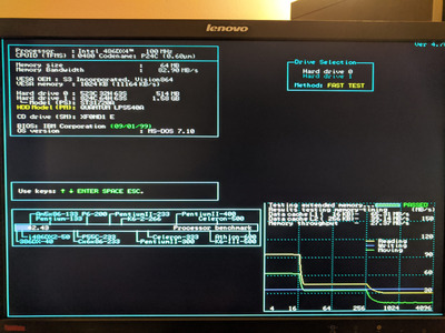

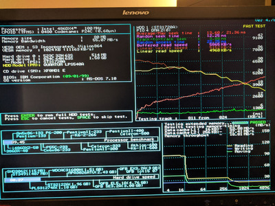

Finally got Speedsys to run. It finished without problem, but the memory and cache speed seems awfully slow. Any thoughts or suggestions? This is for DX4-100/33 MHz FSB speed, Opti 82C802G chipset.
IBM Valuepoint 486 DX4-100, Opti 802G, 50 MHz FSB, Voodoo1+S3 864, Quantum Fireball EX 4.0 GB, Seagate Medalist 1.6 GB, 128 MB FPM, 256k L2

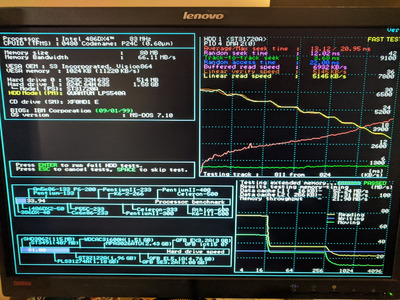

Tried with 40 MHz FSB - processor defaulted to 80 MHz (2x multiplier). Is this standard for DX4's or is this controlled by the motherboard/chipset?
As expected the memory speed is a bit faster with the faster FSB (and so is the hard disk), but still not great. There is a big difference in speed between the primary disk and the secondary disk, which looks like is using DMA access.

Reply 22 of 38, by maxtherabbit
at 33MHz in the first pic your L2 cache gets about the same throughput as the main memory on my 486dx33
you should try to reduce your cache and memory wait states if possible

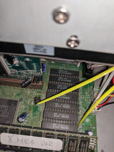

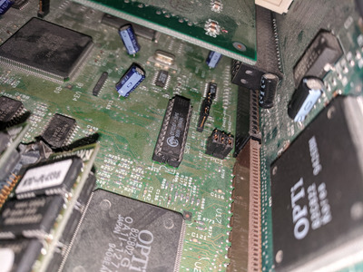

Reply 36 of 38, by chublord
Nice to see a fellow Valuepoint owner, seems pretty uncommon these days!
I am not sure that the actual cache chips were original with the system. It's possible I swapped them out a long time ago (I had a lot of old PC equipment and it migrated between systems). But it does recognize 256k cache. I did not change the tag ram.
I did notice that per the Opti 802C chipset documents, it must be a 15ns tag ram chip for most common FSB speeds.
There's one additional 20ns SRAM chip on the other side of the riser that I couldn't get a picture of without taking things apart.
Reply 37 of 38, by Viserion
Thanks a lot for the pictures.
Just ordered 2 of the 15 ns tag ram chips (one as a spare).
The other 9 I hope I already have the correct type of, but will save your pictures in case it is not so.
Again thank you very much, as I have spent way to much time trying to get information on what chips to get, and hopefully may be useful for somebody else some day.
For record:
CY7C187 - 15PC is the tag ram 22 pin x1
Toshiba TC55328P-20 and/or KM68257CP-20 x9
