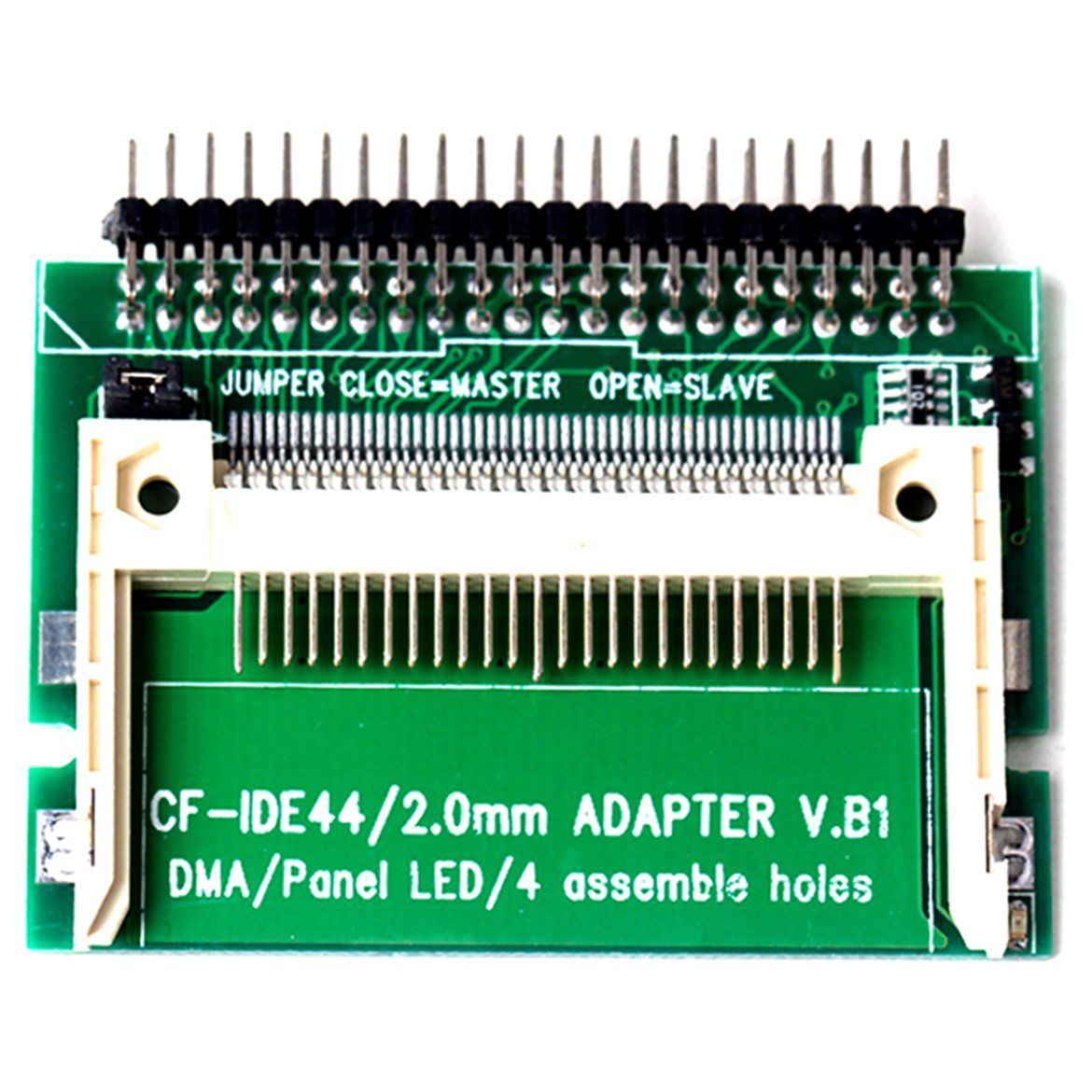

Reply 30 of 33, by MarmotaArmy
Hello,
I'm having a similar issue.
I bought a Transcend CF200i 8gb card , for my pentium 233mmx , MSI 5128 motherboard.
Issue :I just installed the CF yesterday to make a clean Win98SE installation. The board detects the CF card in LBA mode right away , then in the first bios screen it take something like 20 seconds after the ram test get to the OS load screen , then it takes like 25 seconds to begin loading windows (or dos) . I can see the HDD led on the whole time (while doing apparently nothing).
Context : The first time I plugged the cf in I got garbage in c: drive so I ran Fdisk /mbr and then formatted. After that I installed windows.... I got an Critical write error in C: drive while doing the install (abort , retry, fail?) , retried and completed it without problems. I ran scandisk (full) and no bad sectors were found. When I shutted it down it took more than a minute to get to the shut down your computer screen.
It's running , but those very long "first access times" give me a bad feeling
So far reading this thread and another one I guessing I should try
1. changing the adapter...if this doenst work then
2. setting the CF to normal in bios instead of LBA/Large
3. use whatide and type the CHS manually
I have two adapters
This (installed)
LmpwZw
And this
cmllcy5qcGc
The card
Zw
Reply 31 of 33, by douglar
MarmotaArmy wrote on 2023-03-21, 12:52:
You could also try:
  • make sure you don't have power cords tangled with your PATA IDE cable
  • make sure you don't have interrupt conflicts
  • try a PCI or ISA hard drive controller card
  • use a sys info tool that can query IDE devices to check the CF firmware. Might not be a Transcend device under that shiny case
Reply 32 of 33, by MarmotaArmy
douglar wrote on 2023-03-21, 20:20:
You could also try: […]
You could also try:
Thanks for the tips,
Yesterday I tried
2. setting the CF to normal in bios instead of LBA/Large... I tried the auto option in the Standard CMOS setup and it correctly showed the CHS according to Transcend product sheet.
3. make sure you don't have power cords tangled with your PATA IDE cable
4. Setting DMA option for drive in windows
So far.. It starts a little faster . And the OS load is very fast. Also I ran a diagnostics tool and I'm getting neat 13mb/s , double as fast as my HD drive.
But when it comes to "shut down your computer" it takes like 3-5 minutes to get to the "You can now safely turn off your computer" screen.
I'll keep digging next step diagnostic tool. But its running ok so maybe I don't have to poke it so much 😁 , and I will use it mostly for DOS gaming so I'll be accessing windows for usb mostly
Reply 33 of 33, by douglar
MarmotaArmy wrote on 2023-03-22, 12:56:
Try:
1) Disable the shut down audio. Easy enough. Works for some people
2) Go to accessories/system tools/system information/tools menu. Select system configuration utility then change the “disable fast shutdown” setting on the Advanced tab . Click OK before exiting.
3) If those things don't fix it, look for the old win95 shutdown patch and apply it
