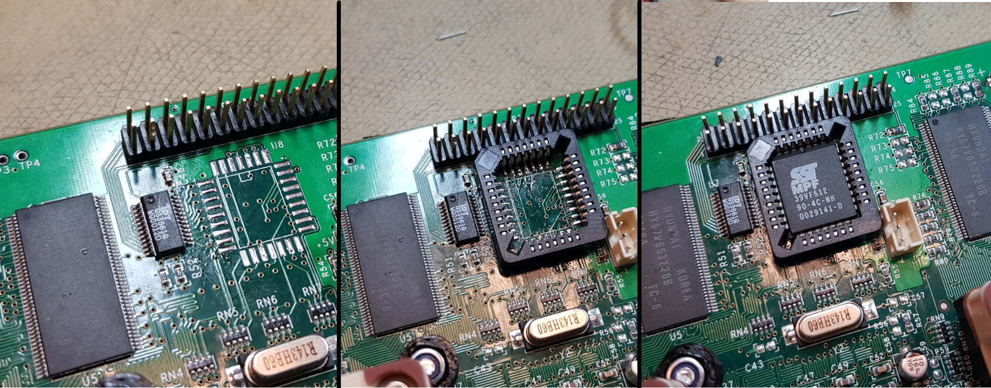

Could these work? having a hard time finding them at suppliers like farnell and ebay.
Reply 22 of 37, by sdz
If they're legit ICs (not fakes or broken pulls) they should work. If shipping takes a long time and you're impatient, you could at least temporarily use an EEPROM from a donor card. Some TNT2 cards have this exact EEPROM, like https://www.ebay.com/itm/InsideTNC-Dream-nVid … XoAAOSwsxFeSaOc . Probably many other cards of the same vintage have it as well.
Forgot to mention, AT49BV512 should also work.

I went over my stash and found the following cards:
I guess the only one that is usable is the 3COM one?
Reply 24 of 37, by mmmark84
on second thought, I might as wel order and wait for new ones from china. dunno if I can recover such an IC with the tools I have, while still being usable.

Reply 25 of 37, by havli
Well, to be honest I am not an expert on external flash programmers. I have one of the chinese clones of TL866 II - that one would definitely work. The simple and cheap ones, I have no idea.
You can flash the new (empty chip) on the V5 itself, sure. I did the same on the defective Banshee (at the time I didn't have the TL866). There is a catch however. The 3dfx flash application only supports few selected chips. I have a list that I found somewhere. Maybe it is complete, maybe not... anyway:
Atmel: 29010, 49F010, 49BV512, 29LV512
SST: 29LE512, 29EE010, 39SF010, 39VF512
AMD: 29010
So It is best to get one of these if you intend to flash it on the card.

ty for the suggestions! I ordered a bunch of these last weekend.
I figured I would order the exact same type as the one on the card now.

I recapped the entire card tonight and tried to flash it again. Same result. Guess nothing left to do but wait for EEPROM chips 😀

Reply 34 of 37, by mmmark84
So I replaced the EEPROM and flashed the card:
Same result....RIP I guess
