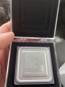

Reply 33 of 120, by chrismeyer6
Sphere478 wrote on 2021-01-19, 19:57:
Looky what arrived today! 😁
Nice! What are your plans for that little beast.

Reply 35 of 120, by Sphere478
chrismeyer6 wrote on 2021-01-19, 20:03:
gonna put these parts around it! Still waiting on a few parts. See OP for specs and plan.
