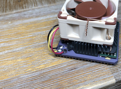

Reply 22 of 33, by criz_me
Alright. As you may tell, I am not good at this, and I am trying to avoid frying my "new" CPU 😉
@snufkin You were right. I measured the pins wrong. In fact, the middle pin is connected to the case, so that is GND then. I switched GND and tach, and got a 84 point benchmark. Regarding resistor color coding, I used the multimeter to determine it has exactly 10k Ohm.
@pentiumspeed Following your advice, I added a 10 Ohm resistor (glad I ordered a whole box 😉 ) between the "real" GND now that I know it, and tach. I am running at full 134 points now! Excellent, thank you!
So, as a last step, you are suggesting to connect GND to tach, no resistor in the mix - right?

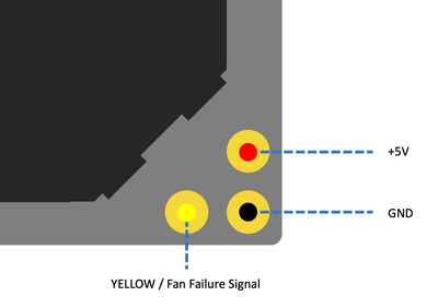

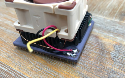

Reply 26 of 33, by criz_me
Success 😀
See attached, this is what I went with instead of graphite. I now have fan and CPU at 100% speed. Thank you all for your help! Also attached the correct pinout, in case others are looking for it.

Reply 28 of 33, by pentiumspeed
criz_me wrote on 2021-04-30, 18:18:
Success :) […]
Success 😀
Cheers
Christian
Please edit that graphic again to prevent misinformation. The overdrive does not use tach, which means to measure rpm (tachometer), correct term I suggest is fan failure signal, normally pulled low when working.

Reply 32 of 33, by B24Fox
@criz_me, sorry to butt-in, but you ignored what could have been probably the best advice, given by maxtherabbit.. which could have had the potential of making everything actually behave like from the factory.
maxtherabbit wrote on 2021-04-30, 16:19:
So if you had the pins wrong, why not just try connecting tach from the fan directly to the tach pad without mucking around with resistors or forcing it low?
Not to mention that the CPU has different increments(steps) of fan-speed sensing and down-throttling, not just on&off (as specified in the intel POD documentation, and also proved by your testing).. and having that circuit in a 0(zero)Ohm short (between Tach and GND) , might not be a very good idea.
The fan might work perfectly fine (including Tach/Sense), if all 3 wires were just connected properly..!
That would have been the most interesting thing to benchmark! As it would have meant that basically any 3-wire 5V PWM Fan, could be a direct replacement for any OverDrive CPU Fan.
If you still have the time & energy, please make this right! I am genuinely interested (as i also have a fanless P24T P.O.D.), and i'm sure there might be others that are too 😃
Reply 33 of 33, by Caluser2000
You my want to turn the end of that lock wire up and towards the cpu so you don't a puncture a finger then bleed all over the mobo.
