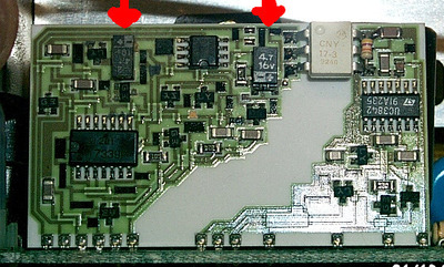

Reply 34 of 125, by dataino.it
paradigital wrote on 2021-07-16, 07:01:
Oh I've successfully booted my PCS 11 with an ATX PSU before with the pinout I described above. As my ATX PSU was newer than the ATX 1.x specifications it didn't have a -5v rail, so I left that out (P22).
I did this months ago mind you. I knocked up an adapter using a filed down du-pont connector for the end that plugs into the PC, and a female ATX connector to plug into the PSU.
I'm pretty confident that my issue is going to be finding a PSU that fits inside the small form factor of the PCS 11. So far I'm coming up short, even most 1U rackmount PSUs are too long 🙁
If you still have the old power supply you should try to change these two capacitors, which are on the feedback line of the power supply , same time solve the problem of death PSU
    110.21 KiB
    1167 views

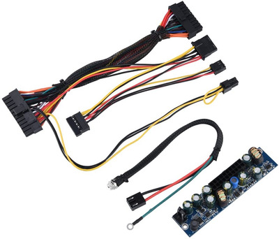

Reply 35 of 125, by dataino.it
If it doesn't work you can replace the power supply with this one, I normally use it with 286,386 ,486 and same pentium motherboards
Obviously with a suitable power supply, I will shortly do it on my pcs11 and let you know
Reply 36 of 125, by Verax
dataino.it wrote on 2021-07-16, 19:29:
Is this message for me or @paradigital ?
Reply 37 of 125, by Verax
dataino.it wrote on 2021-07-16, 19:37:
Okay, but i'm already using a brand new PSU with the PC. 😀 Thanks it can be useful though!
