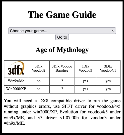

Another useful link... The game guide
Theres so much voodoo info around, but its so spread, sometimes hard to spot 😀

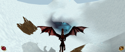

A bit of an update whats happening at my local desk.
Ive been playing with resolutions, I have added all 16:9 that I wanted, 1280x720, 1360x768, 1600x900, and ofc 1920x1080 is working from before.
This is an unrelated test, but games are both in 1600x900
https://youtu.be/YL5piRXHAoQ
Very usable on a 16:9 monitor, this isnt exactly a viable benchmark cus my sistem is definitely not clean, but Drakan at 1600x1024 = 49fps, 1600x900 = 54fps, nothing overclocked.
And then the interesting part. Being a big fan of 21:9 aspect ratio, I started playing with 1920x800... And yesterday somehow it stick. Perf quite usable, at least in Drakan and it looks great. But then I ofc played around some more and now I cant repeat it 😁
This is the only picture I have ingame... and this isnt correct, smeared image, but you get the idea. When it gets sorted, its gonna be fucking amazing.
When this is all done, thats for d3d games, for opengl game, drivers will have to be fixed so it scales the image correctly, thats gonna be a bit more challenging.
