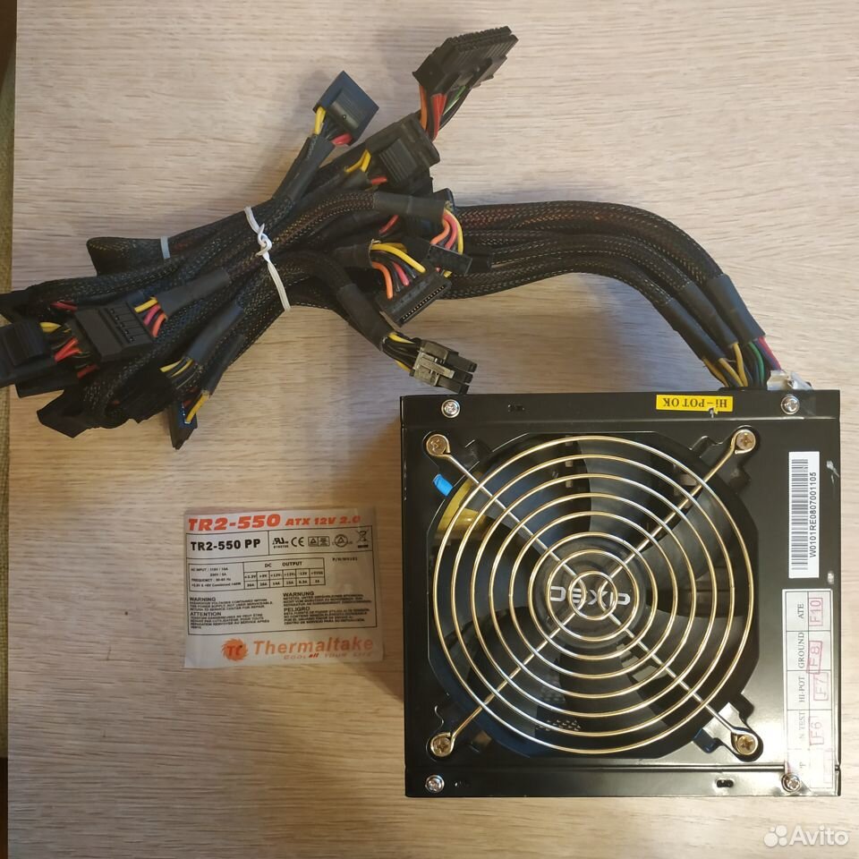

I have this Thermaltake TR2-550 PSU:
1.AqpVXbaxrkNj6ixOXXUUz6P-rkfp_KRB.4nT3vQjawrEHG-HcLTjcWllpXHCA8uiP0GKR-uOQXJc
Will that suit this old PC? It has just one 120mm fan that gets hot air from the case to outside.
No outside fan.
It has a "ATX 12V 2.0" sticker but also has +5V DC.
Reply 32 of 42, by Sphere478
idan182 wrote on 2022-06-06, 12:57:
I have this Thermaltake TR2-550 PSU: […]
bZbZbZ wrote on 2022-06-06, 02:46:
I'm assuming you don't want to replace your case (to one with a dedicated exhaust fan near the CPU), and you don't want to repla […]
I'm assuming you don't want to replace your case (to one with a dedicated exhaust fan near the CPU), and you don't want to replace your motherboard (to an actual Socket 370 mobo).
In this case, generally the best setup is for the front case fan to be an intake, and for the Power Supply to pull hot air from the CPU area and exhaust it out the back of the PSU (out of the computer).
So the first step would be to find another PSU. You can try a modern unit, where nearly all of them use a large intake fan that would suck hot air away from your CPU and through the PSU eventually out of the back of the computer. But there is a risk that the modern power supply might not supply enough 5V for your CPU (modern systems use almost entirely 12V and modern PSUs are designed to match). You could also try to find an older PSU with a similar airflow direction. There were PSUs around the early 2000's with two fans, one pulling air from the CPU area into the PSU and the other fan exhausting out the back of the PSU (out of the computer). Here's an example photo..
In addition to replacing the PSU, I recommend using the front case fan as an intake fan. You could also consider replacing it with a newer/better one (maybe a suitably sized Noctua, although they're pricey).
Good luck!
No outside fan.
Give it a go, see how it does. Also, flip that front fan.

I've replaced the power supply with the 120mm exhaust fan + switched the front fan which was exhaust and not intake.
Temp dropped from:
Motherboard: 36c to 29c
CPU temp: 45c to 38c
GPU temp: 72c to 63c
Hard Disk temp: 45c to 32c
Hooray
