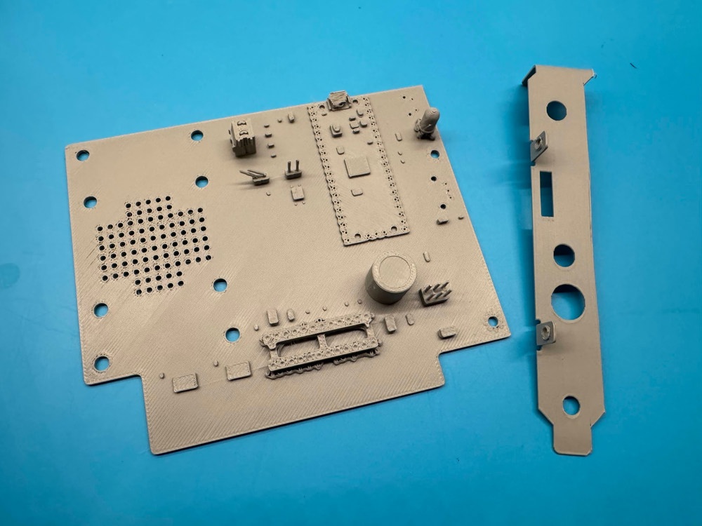

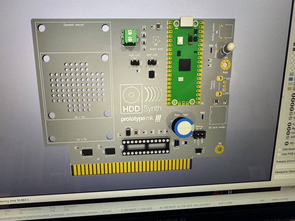

More details on the results of that survey are available on my website, however one of the key take aways is a desire for a non-ISA version of the HDD Synth that is as portable as possible. So when I get the MKIII PCB manufactured in the near future, I'll also have a version that will fit in the 3.5" drive bay of a computer with the option to have the controls accessible via the front panel.
The MKIII ISA card is smaller, due to the use of surface mounted components
I recently purchased a 3D printer so that I can ensure the PCB and the rear bracket align correctly and can be fitted into a computer successfully, ahead of having both parts professionally manufactured.
