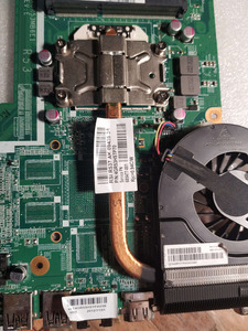

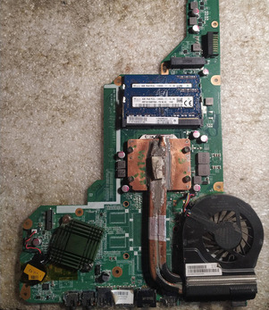

I give as an example a modification that I already mentioned to the heatsink of a laptop, in laptops the space is very limited. I added a second heatpipe and made an all copper contact plate.
This type of modification by adding a heatpipe is quite common, I also did it with my M17XR3's CPU cooler and now the processor goes into turbo mode easily and the fan is much quieter.
If I did it for a laptop, there are many more capable people than me who would be able to make a better cooler for consoles.
