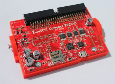

Actually, The ZuluSCSI RP2040 http://zuluscsi.com/wheretobuy perfectly demonstrates that, not only can the RP2040 emulate a high-speed CD-ROM drive at a whopping nine megabytes per second for reads, it can emulate up to seven SCSI devices at the same time, be they CD-ROM drives or HDD's. I own Rabbit Hole Computing, which developed the original ZuluSCSI V1.x, as well as the ZuluSCSI RP2040. ZuluSCSI's firmware is completely open-source (see https://github.com/zuluscsi/zuluscsi-firmware), and leverages the high-quality SCSI command handling originally developed for SCSI2SD (Also GPL-licensed), over the course of a decade.
Rabbit Hole Computing is based in California, but we have a German-based EU distributor of ZuluSCSI products, as well as others in the UK, Canada, and Australia. See https://store.rabbitholecomputing.com/ZuluSCSI-s/120.htm for a list of the various form factors of ZuluSCSI we have available.
By comparison, the original ZuluSCSI (V1.1) hardware, based on a GD32F205 (an improved STM32F205 clone), delivers roughly half the throughput.
For documentation on ZuluSCSI usage, see https://github.com/ZuluSCSI/ZuluSCSI-firmware … /main/README.md and https://github.com/ZuluSCSI/ZuluSCSI-firmware … ZuluSCSI-Manual
Reply 24 of 475, by FreddyV
aperezbios wrote on 2023-06-06, 15:34:
Hi,
The SCSI interface (Hardware) is much more simple than the ISA, with I/O, MEM and 20 Address lines.
The Pico can do DMA transfer on PIO with it.
Also, I am obliged to use the MicroSD in SPI, that is not the case with the SCSI board because there is much more free signals.
At software level, do SCSI is much more simple than what I do with the PicoMEM 😜
