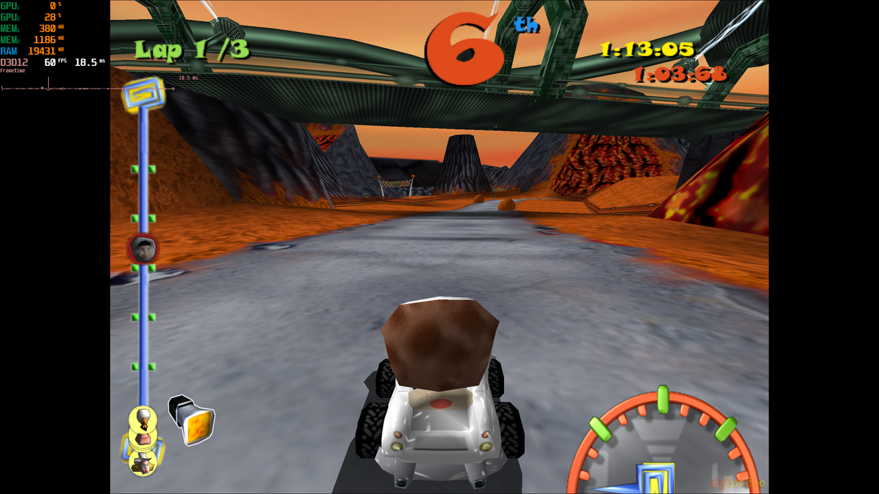

I was trying to find another game that could potentially have similar issue, and I got Toon car. "Natively" it does have 144 FPS and this awful clipping issue
1.82 MiB
1204 views
dgvoodoo fixes the issue but framerate is around 80-90 FPS, and sometimes drops to about 45. CPU behavior is like 70% on one thread and it switches to next thread every few seconds on dgvoodoo.
I guess it's no dgvoodoo for me on this CPU 🙁

I tried it on Ryzen 5 3600, it's still 32 FPS. My friend with Ryzen 7 3800x got 19 FPS on DX11 on 2.81.1(he didn't play with config to check DX12), I tried now DX11 on this version on 5800X and I also get 19 FPS(before it would be no difference between DX11 and DX12 and it would be that 10-11 FPS no matter what). So I guess if my friend would set DX12, he would also get some performance gain, and it's just Ryzen 7 5800X that sucks 😀
I also tried Toon Car on this version, I think FPS now is more stable(but maybe it's just me and I would need to do proper logging to confirm it), however it still drops to 45 in one particular place on that lava map. 3 laps and 3 times it goes down to 45.

I tried it, it's not really different for Toon Car(drops to 45 FPS around that place while using DX12). For Sacrifice it went down from 30 to 28 FPS. I did profilling with the version you sent me in DM previously(I don't know if these .pdb files are compatible with other versions so I wasn't messing with that and just used entire package, so it's before you did the changes that fixed Sacrifice for me).
This is me playing normally 3 laps: https://www.dropbox.com/scl/fi/5e41re6h6udo1p … wscxvxvj5l&dl=0
This is me getting around the spot and idle: https://www.dropbox.com/scl/fi/n18xi5fq345uuv … bykblubtl1&dl=0
The "native" 3D HAL also does FPS drop around this place, but it's not dropping under 100 FPS(I captured FPS with FRAPS).
1.64 MiB
993 views
3D HAL T&L just doesn't care and it's solid 144 FPS, but game is unplayable due to insane clipping.
244.79 KiB
986 views
I picked out Toon car, as it showed similar behavior to Sacrifice(worse FPS compared to non wrapper launch), so I thought maybe it could help diagnose the cause of why it's happening. 30FPS in Sacrifice is pretty awesome, so there is no need to investigate this anymore, unless out of curiosity.

Then this must be some out-of-sync problem instead. I updated the .zip again (reverted the modified code), but now v-sync is disabled to get max performance. I get 150fps at the point I posted on my screenshot, 200+ at other places.
Could you try it again plz? Also, if it's still produces low fps, could you profile it at this point again? (and tell me the time range of idling with the car)
Btw, HAL does all the vertex processing on CPU, while TnL HAL does it on the GPU. That's why the difference with native DX.
With dgVoodoo it's all for the same, vertex processing is always done on GPU from Draw calls.

Ok, it's not vertex data. This game calls surface GetDC/Lock per frame which is expensive, especially for large application resolutions. Try option DirectX\FastVideoMemoryAccess for such games or select a low resolution in the game (for example 640x480, like I did) and scale the resolution by forcing through dgVoodoo.
Reply 38 of 38, by Darkstorm
Yes, fast memory access helps a bit, I think about 30% increase in that spot in dx12, but resolution helps a lot(I used FHD since I thought it's not demanding game, 6 cars and something sometimes happening on the screen that I can max out settings and that's it). So it's nowhere close to that case of Sacrifice and I guess that wraps it up.
