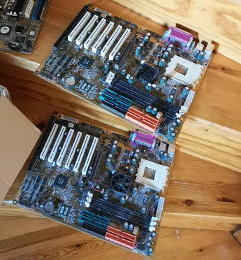

Reply 217 of 365, by dj_pirtu
Look what I've got today! Two v1.2 KT7A-RAIDs.
Going to test these on weekend... with Geforces. 😉
Edit: first one on testbench, geforce 6800gt gives blue screen for nv4_disp.dll like my previous KT7A when playing FlaOut2. And PS/2 keyboard port is dead. Lights blink on keyboard when turning on but that's it. Mouse-port works. Fuses are OK.
Edit2: second tested, same thing with geforce, bsod with nv4_disp. It's going to look like a software problem if all my four KT7A (KT7A v1.1 & v1.3 and KT7A-RAID v1.2 & v1.2) mobos dont like geforces...
Edit3: this fully working mobo takes FSB like crazy 😮 with default voltage 152MHz. Runs 3dmarks fluently (with Radeon X800Pro). My previous boards took maybe 145MHz and that's it.

Reply 218 of 365, by chrismeyer6
Nice finds. I'd love to get at least one more of them in my collection. They're one of my favorite non-DDR Socket A motherboards.
