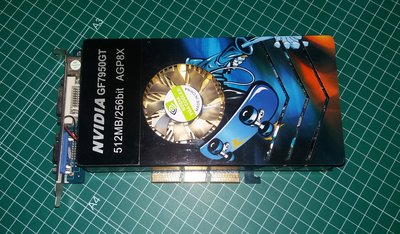

Hi,
I bought this graphics card, NVIDIA 7950GT AGP version.
The attachment 20171206_171813.jpg is no longer available
I think that this graphics card are one of the last sold for AGP bus.
It works very well in my Pentium 4 and there are a lot of difference with the previous installed card, a NVIDIA GeForce 6200.
Doom 3, Quake 4 and Painkiller waits me!!! 😈

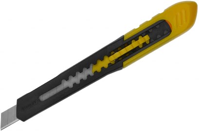

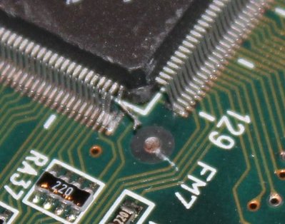

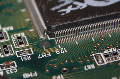

Ugh, I have fixed Voodoo 2's like that, but this one is in pretty bad shape. I have successfully used a hobby knife like this: https://www.afbreekmespunt.nl/894-home/stanle … ekmesje-9mm.jpg to seperate the legs. But it looks like one or more might have been seperated from the PCB in yours?
Good idea, thanks!
Yes the outer one seemed to be separated. Looks very fragile at the moment. Not sure if this Pin is connected at all, but it seems to go to that hole to the bottom side...
Dont know if I get this fixed again...then there are those missing parts on some bottom side.

That's the raddest, most tubular card I've ever seen! 🤣

Assuming the leg doesn't bust off when twisted back into place, that's a doable repair for a skilled tech. I recently just repaired an Ensoniq SoundScape OPUS with the same exact damage.

I would trim the leg a little bit, but leave it as is. Then solder a small wire-wrap wire to the trace, with the other end soldered to the lead sticking out of the chip. I would not bend it back into place. This depends on your soldering skills, but this is fixable. If you bend it back and it breaks, you may end up having to dremel into that part of the chip to get access to more of the lead frame, and do the same.
What I mean for wire wrap wire (this sort of stuff is used as bodge repair wire all the time):
https://www.adafruit.com/product/1446
Reply 20612 of 60056, by FesterBlatz
Good advice! Best to not tempt Murphy's law. I generally try to make my repairs look...well, invisible. But my German OCD is the reason for this. A functional repair is certainly more valuable than a failed attempt at a pretty one.
Care must also be taken not to lift that pad. Lots of flux and swift use of a fine curved tip of a QUALITY soldering iron are paramount.
Personally, if you're serious about fixing it I suggest having someone experienced with this type of work take a crack at it.

Note for the faint of heart for sure.

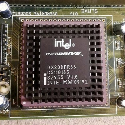

I'll post full photos of this purchase later, but for now I need a bit of help in understanding what I bought..
The attachment 486OD.jpg is no longer available
This socket comes populated with a 486 Overdrive CPU. My understanding is that it is a replacement Overdrive, so despite the socket being labelled as Overdrive Socket any PGA-168 486 CPUs (ie. a 486DX33 or a U5S SUPER-33) should work with this board? In theory even a DX2-66 5v would work on it except that mounting a heatsink is impossible due to no Socket 3 lugs? Am I missing anything?
Also, what is the difference between the 486 Overdrive DX2-66 and regular 486 DX2-66? Both are 5V..
Reply 20618 of 60056, by Deksor
IIRC the DX2 overdrive has write-back l1 cache. But that's it ...
It also depends if your overdrive has 168 or 169 pins. A 169 pin chip will fit into a mobo with a 487SX upgrade socket.
Some heatsink will clip on the chip itself rather than on the socket so if you find one of these coolers, you will not experience any problems.
Reply 20619 of 60056, by appiah4
So I can easily remove this OD CPU and replace it with, say, a U5S SUPER-33 or a regular DX2-66?
