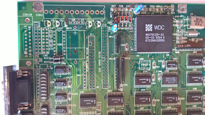

Reply 225 of 228, by popolou
Such a cool place and so incredibly heart warming to see that the Mega PC lives on. I hope i'm not late to the club. I also hope the thread is just taking a rest.
I recently found my old Mega PC (with the 486SLC 25MAB chip) in my storage facility and with it all my original games and disks. I still think i have the keyboard, joystick and game pad somewhere but i was lucky to have found both the system and monitor in very original condition. You can imagine my delight when i discovered it all working again when powered up. The (noisy!) sound of that 40MB drive almost had me tearing up, honestly. The Mega PC, which i had from new, was my last in a whole string of Amstrad systems i bought into before moving on to Dells starting with their first Pentium 60. Goodness, we even had each one of Amstrad's first and send generation Emailers!
However (and yes, the tone drops a little), the dead battery was so kind to do its thing and cause some greenish blue fuzziness around the board which did eat up some of the traces. I have attempted to repair some and it's been largely successful but i may return to this in the future. The main problem at the moment is that whilst it POSTS fine, there is clearly something wrong with the disk controller: errors on bootup are the two Diskette Drive A error and Fixed Disk Controller Failure messages.
Curiously, i do vaguely remember having this problem over 20 years ago and i think my simple workaround was use of the IDE header on an ISA sound card but my memory fails me. I really want to try and fix this.
I obtained the service manuals (my thanks too to @dioxaz) and am probing the WDC76C20 for faults. It appears to be powering up fine and traces to/from it are also fine. Those traces around the battery affected some of the power conditioning but with some repaired, it is not seemingly affecting the controller. I don't have an oscilloscope but i suspect i am going in that direction. That both the chip is controller for both floppy and hard disk suggests it is either a problem upstream or that the actual chip is faulty. However, this chip was hugely popular for PC clones at the time and i have not come across other stories of it failing.
I hope to post up pictures of another saved Mega PC but in the meantime, is anyone able to shine a light as to what i could do to troubleshoot the onboard controller?
Cheers!
Pops
Reply 226 of 228, by keropi
popolou wrote on 2024-02-02, 22:28:
Such a cool place and so incredibly heart warming to see that the Mega PC lives on. [...]
welcome!!! always nice to see another megapc getting saved 😀
maybe the issues you have are bad traces under the fdd/hdd connectors, I had removed mine and took some photos - maybe they help you find the issue , I am attaching the relevant photo in this post
I seemed to have missed the service manual for the WD 386sx based mobo, can you link it here? I too have a dead 386sx mobo that I am attempting to revive ....

Reply 227 of 228, by popolou
Ah kala, thank you for the welcome! Yes, i am probably going to have to lift the headers to examine their condition - some of the pins appeared to have weakened over time so those were replaced. I suspect i am going to have to follow the trail and see where it takes me.
It seems my copy of the 386SX Service Manual is some 30MB in size so couldn't attach it - luckily there is a copy available from here. I believe there may well be a later revision of it because i have come across some inaccuracies with a few of the schematic diagrams (but the PCB layout appears to be correct and reliable).
It's quite intriguing there is so little on the actual error itself available online; I'd have thought there would have been some analysis of this controller what with it being so common. Perhaps that would have been too easy!
Pops
Reply 228 of 228, by keropi
thanks for the link of the SM , it will really help with troubleshooting!
yeah, removal or the headers is probably the only way to make sure there are no issues under them, please update on your progress and good luck!
