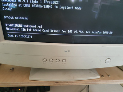

Hello JazeFox, I have problems using unisound 0.75e with the Orpheus card on my 486DX2 build. Here's hopefully relevant info:
- unisound hangs when I launch it
- unisound /cl shows it partially detects the card but hangs there (screenshot at the end)
- I'm using SET BLASTER=A220 I7 D1 T4 and unisound with no parameters. Tried without the set blaster and same result.
- Tried with empty config.sys and autoexec.bat (with or without SET BLASTER first) and same result
- Same card, same unisound executable, same settings work fine in another machine
- On the problematic machine, if I switch the Orpheus with my ESS1868f (same ISA slot) unisound detects it fine with the exact same config
I'm at your disposal for any test or any question.

Reply 250 of 845, by JazeFox
Boohyaka wrote on 2020-10-13, 10:41:
Hello JazeFox, I have problems using unisound 0.75e with the Orpheus card on my 486DX2 build. Here's hopefully relevant info: […]
Hi!
Thank you for reporting this! I was working last days on some bugfixes for the Orpheus (mainly mixer ones), so let's check this out... Some questions:
- Any other card present in the system?
- Can you detail your full system specs/config? That may help...
- Try with UNISOUND /F and let me know if something changed
- Try with UNISOUND /XXF and let me know if something changed.
Thanks!

Reply 251 of 845, by Boohyaka
Thanks for the quick answer!
I removed everything I could to exclude incompatibilities or conflicts, so right now the config is:
- Soyo SY-025K, 486dx2-66, 16MB RAM
- UMC 8672 I/O VLB card
- Cirrus Logic GD5426 VLB VGA card
- Orpheus, obviously 😀
UNISOUND /F: hangs the same
UNISOUND /XXF: hangs the same
Reply 252 of 845, by Boohyaka
So after a lot of investigation and time from JazeFox (awesome lad!) I'm happy we were able to fix it! For some reason my motherboard and Orpheus combo is super picky with AT bus clock.
It started working when setting timing to CLKIN 1/6.
Huge thanks again for your time JazeFox 😀

My initial (stable) configuration was CLKIN 1/2. Then when I had the issues I went back to BIOS defaults thinking it would be most compatible, which sets AT bus clock to 7.159MHz, still didn't work.
Then JazeFox recommended I basically tried all timing settings and the bottom line is: 1/2 1/3 1/4 1/5 don't work, 1/6 1/8 1/10 do.
keropi wrote on 2020-10-15, 08:54:
is it 66/6=11mhz the new setting?
Yes!

@Boohyaka
I'm glad it finally worked on your mobo 😀 Yes, sometimes there are motherboards with different default clock settings for the ISA bus, and some ISA cards don't like them. 99% of the times issue is solved just picking the corrrect value. As we talked by PM last 2 days when testing, I had problems in the past with some sound cards caused by those clock differences, so my suspicions were confirmed...
Well, enjoy your new Orpheus card! 😁
