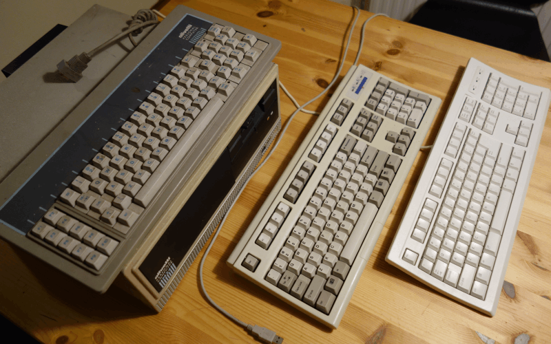

On to happier things. Today is keyboard day:
The disappoinment is the white Alps board. Bought based on a fuzzy picture, though mercifully I didn't pay much for it. Before today I didn't know Alps made (bad) rubber dome keyboards. Now I do...
The one behind it is nicer, a Unicomp buckling-spring board, i.e. supposedly the IBM Model M reincarnated. I wouldn't go that far, the build quality and sheer weight and stability doesn't come close - but it still types gloriously and has USB to boot. Needs a bit of a clean though.
And finally I at last got my hands on a keyboard for my Olivetti M24 (pre-XT PC-compatible with some AT-class features - and a totally non-standard keyboard interface). Just one 'problem': it came with another M24. This one's much less pristine than my original one, and is supposedly dead or dying - booting maybe one time in ten. But at best I can fix that, at worst I have a pile of spare parts for my other one. Also, this one has a beautiful and absolutely huge Microscience MFM controller, with matching 20MB drive. The other one also has a 20MB drive, but stepper, not voice coil like this one. I'll probably be moving this drive over for starters 😉
I even have a purpose for these dinosaurs: my partner wants to start our son playing Sokoban. She wanted to do it in Dosbox on a tablet. I have a better idea 😉
