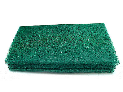

Here's a tip for those dull, corroded expansion card back plates: a green sponge commonly used for scrubbing pots and pans works wonders to make them shiny again without being too abrasive. These pictures don't do it justice:
Not bad! At least easier than using a flap wheel
Great parts btw! Caching 386 boards are cool 😀
I'll try it on the Audigy 2ZS that I got recently. It's got a bit of a patina. 😢
