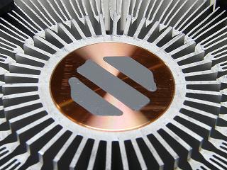

you know if you don't apply thermal paste correctly and in the right amount it makes your temps go. Most people think it's okay to use old thermal paste, lift the cooler up and then clamp it back down using the same paste, spread the paste and use pea size dot of paste, witch are all wrong.

If there's a heatspreader, the Arctic Silver engineers suggest either a line or a drop application, depending on the shape of the CPU die beneath the heatspreader. Apparently the majority of the heat conducts through the metal in contact with the die so it is critical to have a good paste application above the die. Trying to do the whole heatspreader tends to make contact worse because you usually introduce air bubbles if you try to spread the paste on your own.
If there is no heatspreader then they recommend a thin film spread by hand because there's a risk of a drop method not covering the entire die surface and that would be very bad.

IMO the paste issue is totally overrated. There isn't much you can do wrong, apart from not applying any...

Well the preapplied stuff is usually that way although I've seen Intel use 3 separate preapplied paste sections on their heatsinks.
I agree that people tend to get way too caught up on pastes and how to use them. I've switched to buying the cheap Ceramique 22g syringes these days.
