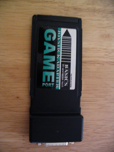

Reply 59 of 74, by retrofanatic
The only thing that has kept me from using a laptop as a dos gaming rig is the lack of a gameport. The only recolection I have of a portable with a 15-pin gameport is some compydyne or micron laptop advertised in a Computer Shopper magazine (yes the ones that looked like phone books!). Does anyone have a real 15-pin gameport on their laptop that can work with dos games? I can't use usb controllers because usb to gameport doesnt work for dos but does of course work for windows games.
I am aware that there were PCMCIA adapters like this, but I think they are pretty rare...
135.08 KiB
4026 views
I did find this link that may be an older website that seems to be selling something that might work:
