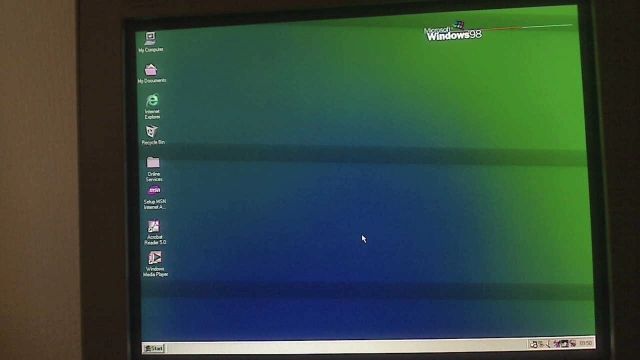

one would think so , but obviously no , the distance it traveled was about 400 miles , and it was well packed ,which only leads me to the conclusion that UPS were using it as a football.
if anyone has an idea of how to fix this, I would be happy to hear it, since otherwise its actually a pretty good monitor. degaussing does decrease the effect, but it doesn't solve it, especially the heavily affected area at the top right of the screen
if I turn it upside down , the area affected changes, decreasing a bit.

If you move a CRT too far north or south this can happen due to differences in the earth's magnetic field. But you shouldn't see this effect if it traveled only 400 miles.
Try opening it up, see if there's anything loose or misaligned around the CRT neck. There's usually a line of paint over the coils, magnets and stuff so you can see if anything was moved.

interesting thing happened , I left the monitor standing (and unplugged) for about 9 hours and decided to turn it on again to see if there are any changes before I resort to opening it up , the picture looks different now
if one compares it to the first picture (as opposed to the 2nd one where it was upside down) , the affected area has been reduced
any idea what is going on with?

The magnetisation will get weaker over time, but if the built-in degaussing coil can't get rid of it right away, it will take a very long time to vanish. What would help is an external degaussing coil, but these are not exactly easy to find (they are rather easy to build, but this would be a lot more dangerous than opening the CRT if you don't know what you are doing). If you know a TV repair shop that once in their lifetime serviced CRT TVs, chances are high that you could get help there.

The degaussing process only takes a few minutes, so if they are nice, it should not cost very much.
Darkman wrote:
a bit of a dilemma, how long is "very long"? days? weeks?
It depends on how strongly the shadow mask was magnetized, but my estimate would rather be several months or even years.

its actually an aperture grille CRT so it might be different, unless this applies to both kinds?
Reply 56 of 555, by 5u3
There may be a difference, but the principle is the same. I once had a Samsung 959nf CRT that got magnetized so badly that some wires of the aperture grille stuck together. It was possible to set it right again with a self-built degaussing wand, so it really should be a piece of cake for a repair shop.
