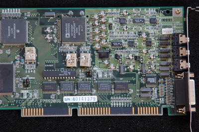

Just to follow-up, I was able to repair Predator99's Dead SPEA S-2000.
I had to re-flow the Sequoia chip! The board is flawless but the solder joints on Sequoia looked..."questionable" under a microscope. After a brush of liquid flux and quick hot-air reflow, the solder joints now look as they should and board came back to life and works perfectly.
I'd like to note that this is my THIRD Ensoinq sound board with poor quality soldering on the fine-pitch chips. I've had two OPUS boards from eBay were the OPUS chips were literally falling off of the PCB!
Predator99's S-2000 was also suffering from some leaking capacitors. The 1uf 50v caps are all beginning to show signs. Fortunately I bought enough spares when repairing the first S-2000 to replace the worst of the bunch, but I'll re-cap the entire board next time I order parts from Digikey...

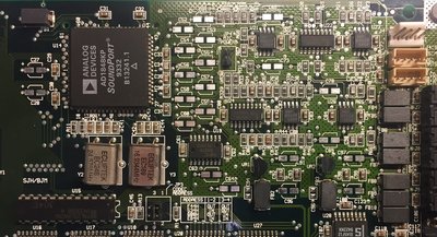

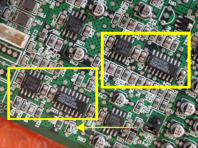

As I do not wiant to start a new thread I revive this one here.
I have an issue with my Soundscape Soundcard.
Initialisation works without any issue and I am also able to hear Digital Audio and Wavetable. Unfortunately the volume is extremely low.
So I thought it makes sense to recap the card just like it was shown in this thread. (My solder skills are not so good anyhow).
Unfortunately recaping the card did not solve the issue. The volume has not changed at all.
So my next guess is that at least one of the 4564 Amplifiers went bad.
There are 4 x 4564 AMPs.
I think that the 2 AMPs in the lower row are meant for the Line Out and the 2 AMPs in the upper row are for Mic or Line In?
Do you think it is a good and the best idea to exchange one/both of the AMPs in the bottom row?
Will this solve the issue? Are there other analytical methods to see if one of the AMPs is faulty?
I hope to hear some of your ideas!

I analyzed the audio pathway and checked the input to the amplifier and the output after amplification. And it showed nearly the same volume level.
So I exchanged the Amplifier 4564 closest to the line out and the slot bracket of the card.
And what can I can: it works again!
So keep in mind that exchanging the capacitors can help regarding low volume issue, but there can also be an issue with the amplifier!
