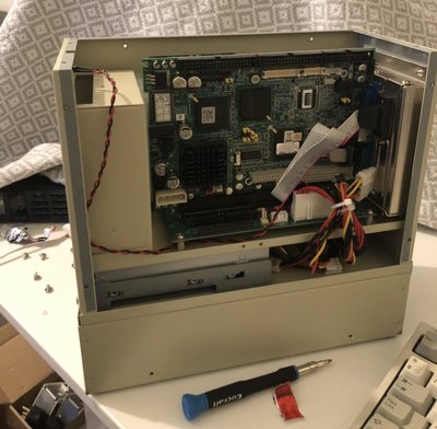

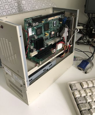

So I finally got some sbc’s and The first case.
Question is, do I need a fan in the case or not?
I added picture one with and one without
naa, nothing yet...
Reply 56 of 67, by tabm0de
I might just get a 80mm and mount it directly to the case without the big metallic holder if it is needed.
It’s like it was mentioned before the pca-6751 does get hot, also I’m unsure if I will use that sbc because of screen configuration is need so using a screen whit high resolution will just make the vga games show as a small screen and with black boarders 😒
naa, nothing yet...
Reply 57 of 67, by aleksej
For first test it with no fan and chassis cover closed. Just run DOOM and left it in their cycled demo playing mode for hours or whole 24-hour marathon - this is the best. No lockups - your luck.
Very strange. I never discovered that issue with my PCA-6751 especially and C&T 6xxxx video chips in general. What display do you use with it?
Here you may see i using my PCA-6751 with CRT monitor. Pure DOS. War never been so much fun in their fullscreen VGA glory. 😉
Reply 58 of 67, by tabm0de
Sadly IM using it with a tft screen. I’m been trying the different settings and I will always get borders depending on resolution of games, vga/svga.
I putted in a ATI Graphics Ultra ISA MACH8 that works good without any doing settings 😉
naa, nothing yet...
