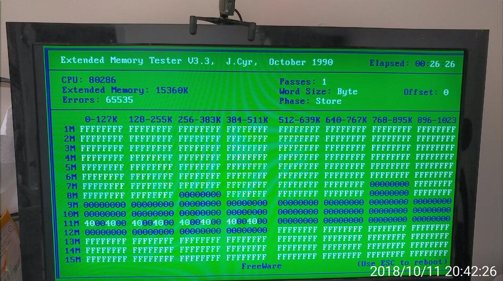

Reply 43 of 147, by stamasd
Log of today's activities with the "M A Systems" card.
Switch 5 on, all others off, same result as with all off.
Switch 6 on, all others off -> computer doesn't boot. 😀

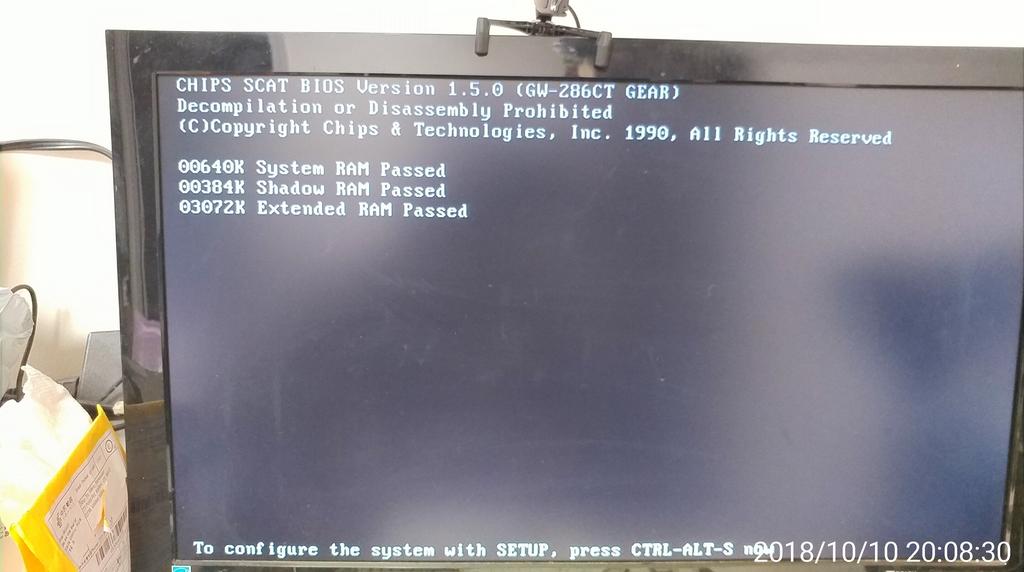

Switch 7 on, all others off -> 3072kB extended RAM recognized at boot.

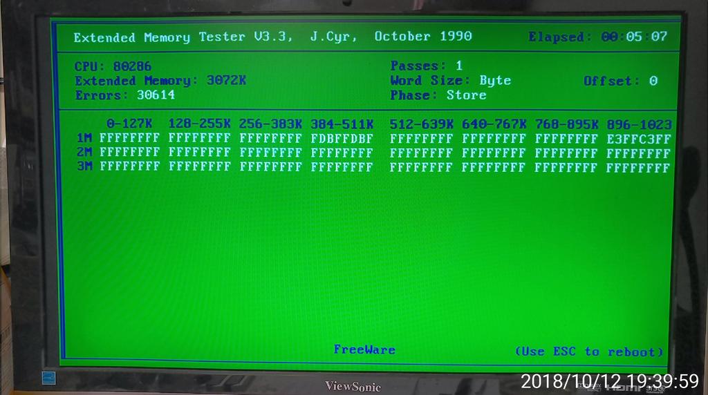

The test is a bit puzzling:
The tester program sees some memory in the first MB above 1M, but also a lot of errors. How did the BIOS recognize it all then?
I tested again the same configuration after a power cycle, and it gets even more puzzling.
Scratching my head here.

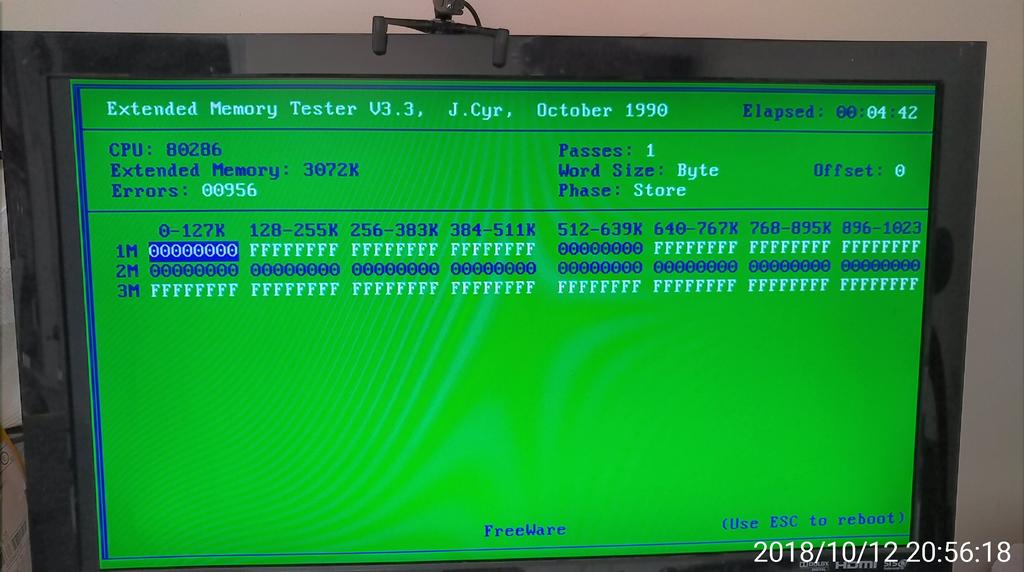

Switch 8 on, all others off:
Test:
Switch 9 on, all others off: same as with all switches off
Switch 10 on, all others off: parity error
So at least the role of switch 10 is clear. Off=enable parity, on=disable parity.
Gonna leave this here for now. Head hurts. Need sleep.

Reply 45 of 147, by stamasd

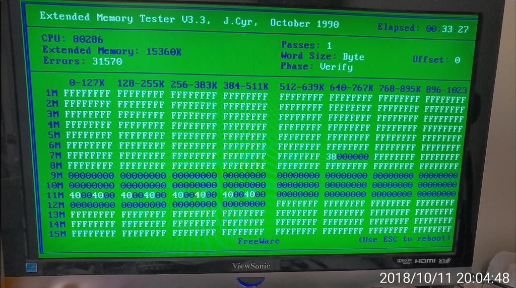

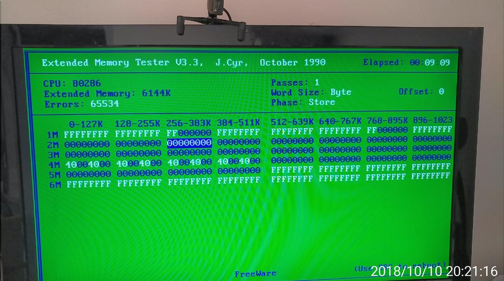

So to sum up the results so far: switches 1-10 xxxx-xxxx-xx
a. 0010-0111-11: 2.5M at 8M, 1 defective chip in 9M region
b. 1111-1111-11: no XMS
c. 0000-0000-00: 3.5M at 1M, same defective chip at 3M
d. 1000-0000-00: same as c
e. 0100-0000-00: same as c
f: 0010-0000-00: same as c
g: 0001-0000-00: same as c
h: 0000-1000-00: same as c
i: 0000-0100-00: no boot
j: 0000-0010-00: 3.5M at 2M, with 1 defect at 4-4.5M and another questionable region at 1M
k: 0000-0001-00: 3.5M at 2M with defect at 4-4.5M
l: 0000-0000-10: same as c
m. 0000-0000-01: parity error at boot
n. 0000-1100-00: 3.5M at 9M with 1 defect at 11M and questionable block in 7M area
o. 0000-0110-00: no boot
p. 0000-0111-00: no boot
q. 0000-1110-00: 3.5M at 9M with 1 defect at 11M and questionable blocks in the 7M, 8M regions
switch 10 toggles parity apparently (doesn't explain #a though)
switch 7 seems to swap in some memory in the megabyte before the 3.5M that show up constantly.
switch 6 seems to lead to some memory being paged where it shouldn't be (in the first megabyte perhaps, conflicting with the onboard RAM) except if switch 5 is also flipped and then the card's memory appears above 9M.
I have no idea what switches 1-4 do. Same for 9, and 8. Well 8 in one instance moved all RAM by 1MB up.

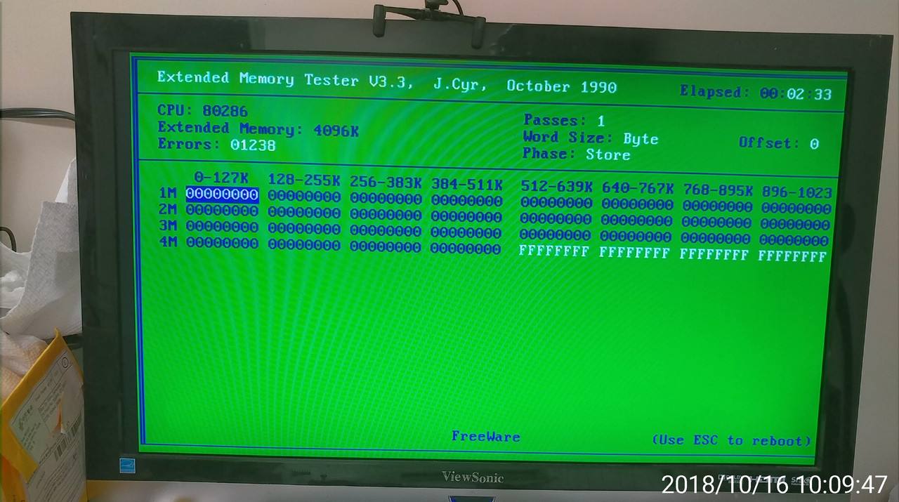

Reply 48 of 147, by stamasd
After running some tests with the baseboard only, I can see some patterns... they don't make sense yet, but they're there. And they're similar to the tests ran with the daughterboard attached.
a. all off, 1024k found at boot, 1024k tested good after the base 1M
b. sw6 on all others off, doesn't boot
c. tests with only a switch on and all others off: (only one of sw1, sw2, sw3, sw4, sw5 was on) all show same as #a above
d. sw7 on, all others off: 2048k XMS counted by the motherboard at boot; testing shows this:
e. sw8 on, all others off: boot screen (seems like XMS is detected at boot but tests bad, not like other tests where XMS isn't detected at all)
Quick test of this configuration covering only 3M XMS:
Notice some weirdness in some blocks on the 1M line.
Tested again after power cycle, this time full 16M:
sw8 is weird. Moving on.
f. sw9 on, all others off: same as #a above
g. switches: 1,2,3,4 all on, all others off: same as #a above
h: switches 1 to 5 on, 6 to 10 off: same as #a above
i. switches 1-5 on, 6 off, 7 on, 8-10 off: again 2048k XMS counted by motherboard at boot, then this:
Compare to #d, see similarities: I saw a similar behavior for switch 7 in the tests with the daughterboard attached, see previous posts.
I still have no idea what switches 1-5 do; they seem to have no effect. 6 prevents boot unless 5 is on also (prev post), 7 brings online some blocks of memory but not others, 8 behaves strangely, 9 is like 1-5.
At least the line with the defective chip doesn't show up anymore so the chip that needs replacing is probably on the daughterboard.

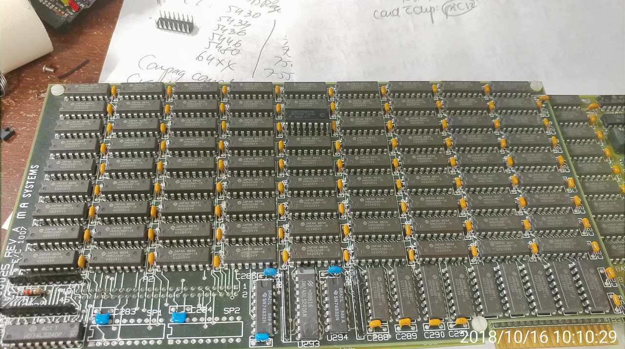

Oh yes and a picture of the card without the daughterboard:
Notice how the connector between the 2 boards is labeled "optimizer" 😕

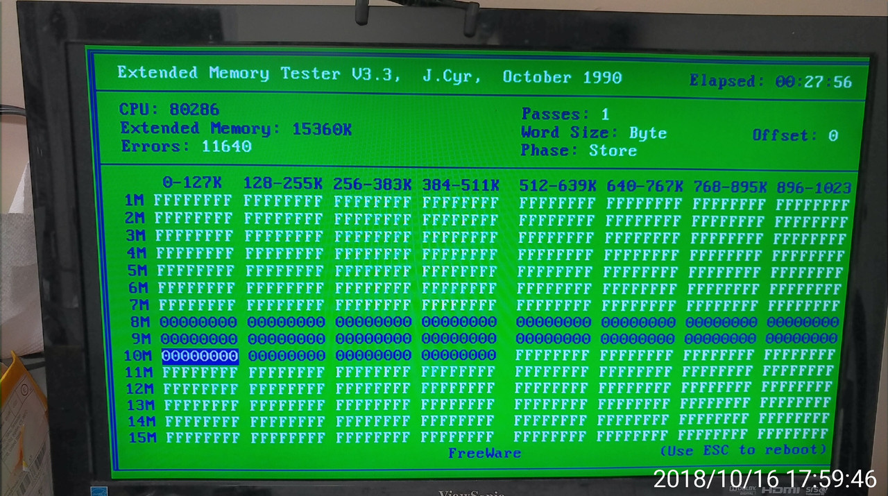

Reply 56 of 147, by stamasd
I've come back to report success. The board is repaired. 😀
I started this morning another series of tests, this time using a carpet-bombing technique. I took 9 good RAM chips and started piggybacking a whole column of chips on the daughterboard at a time, starting with the first on the left. I was intentionally sloppy in my piggybacking technique, hoping to introduce new errors during testing so I can figure out the layout of the memory banks. It worked.
I started seeing new errors in different regions of the memory, and the errors started moving around as I moved the piggyback chips to the right one column at a time. I won't post many images here though I took pictures of everything. Eventually I started seeing new errors in the same region of the memory with the defective chip, and that's when I knew I had the right column. That was the 5th column from the left.
I then started removing chips one by one from the bottom of the column, then from the top until I isolated the chip which would correct the original error when piggybacked (with good technique this time). It was the 3rd chip down from the top of the 5th column (dammit the 5th column strikes again like in the Spanish civil war).
When this was confirmed, I proceeded to unsolder that chip, solder a 16pin DIP socket and installed a good chip in it. The board tests good with 3.5M of XMS now.
The location that was defective with good chip piggybacked
Testing result in that location
Bad chip out
Socket with good chip in
Final test to confirm repair
Interesting observations based on the physical location of the chip relative to the memory error it was generating:
1. the order of the chips in each column is reversed on the daughterboard as opposed to the mainboard. I.e. the MSB is at the top, LSB at the bottom, parity bit still at the top.
2. The row of chips at the bottom of the daughterboard is probably part of the first bank as the bad chip was found in the 5th column instead of the 6th as I expected.
Anyway I have now a working board with 3.5M usable XMS. I don't know where the other 1.5M are hiding but I spent enough time on this project so I'm going to leave it here for now.

Reply 59 of 147, by stamasd
So I redid the full extended memory test after repairing the board with the switches in the original position. Nothing hidden.
