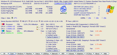

1. Really need the 2nd CPU terminator card if you are running in 1 CPU mode.
2. Have to be matched set of CPUs and correct one that works with this motherboard. Cheaper to just purchase two matched set from any online like ebay, together or one by one.
Use any 4 wire fan for now, the pinout is same for power and tach rpm. The 4th pin not used is for PWM to control rpm speed, will run full speed to test by plugging in.

I should clarify, I do actually have the termination card, or a termination card Asus c-p2t pc100
I have cleaned up the board and now the errors that I got in the bios last year are gone (could have been from the bios update TBH).
I have installed 98se and put in a voodoo 3 and it all seems to work fine. I guess I'll look all over for a matching CPU then install 2000 or xp. Out of curiosity, what is the best cpu rev 1.03 of this board can take?
