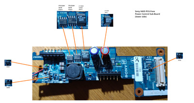

Watching the bench psu when I put this one up to 19v, the power LEDs on the laptop do not light and it does not respond to the power button. Very low current consumption.
If a CMOS battery is fitted it will remember this power fault state until the CMOS battery is removed, so this laptop no longer has any RTC battery since the fault state is easy to trigger and pulling out the battery every time is a nuisance.
The laptop is completely non-functional when used with its original power brick.Strangely I found that when I reduced the voltage to 18.4v the laptop would not go into that power fault state and would run.
I've just ordered an adjustable bench psu for myself so that I can verify if the above is the same with all three power boards that I have in my possession. If that is the case then perhaps we can start to track down the underlying component fault.
Just for kicks I re-assembled the 807K (the one which was delivered working, and from which I took the working power board) and it, of course, is also now dead. It will be really interesting if I can verify whether any/all of the power boards actually fall in to the same category as yours; faulty at 19.5v, but live at a lower voltage.

Bench power supply arrived this morning.
- I have tested all three power boards (one from the 809K which was bought non-working, one from the 807K which *was* working for 2 days, and one spare bought in unknown condition)
- Both laptops
- Voltages from 12v up to 20v DC
No change in behaviour. No visible draw on the bench supply (but it only shows a single decimal, so if it were lower than 00.1W or 00.1A it wouldn't register).
I'm not sure there is anything more I can do. The whole lot is now just a big pile of junk parts. I can keep the MMC-2 modules and RAM, but that's about it.
https://www.target-earth.net
May as well hang onto the power boards in case they can be fixed. Can you find any replacements for the ICs?
I think that's a pretty sensible idea. My next task will be identifying the IC's (some of them are tiny, and my middle-aged eyes not so great any more!) and seeing if we can work out their function.
Perhaps there's something in the list that will immediately jump out as being a possible issue.

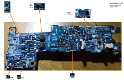

If anyone can help identify the IC's from the markings it could potentially help identify a cure for these faulty power control boards:
So far I have the following IC's listed:
Part Number(s) / Quantity / Pins / Manufacturer / Description
355A / 2x / 3 / ? / MOSFET
A00B / 3x / 5 / ? / ?
LT 1621 / 1x / 16 / Linear Technology / Rail-to-rail current sense amplifier
LT 1435A / 1x / 16 / Linear Technology / Synchronous step-down switching regulator controller
I?R 024H 4U3E f7413 / 2x / 8 / ? / ?
E2LD / 1x / 5 / ? / ?
4925 ?EUA W048 / 2x / 8 / ? / ?
?415A T07BAN / 1x / 8 / ? / Power control transistor
??? / 2x / 8 / ? / Tiny: 2.5-3mm wide. Almost impossible to read markings.

Input voltage is still present on that pad on the power board I identified earlier in the thread, so it's still getting from the DC jack and motherboard to the sub board.
It's got to be one of these power control IC's. But (a) I don't know where to start, and (b) some of them are way beyond my eyesight and soldering ability 🤣!
I can solder these but I don't know if replacement parts are available, which part is bad, or how to test any of them.

Did anyone ever find out if replacements for the ICs are available? There's not that many on there and it wouldn't be difficult to replace them, you only need replacements.
